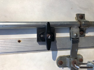

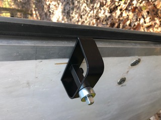

Re: Rear barn door lock?
Postby Modstock » Thu Nov 12, 2020 10:29 pm
Here's pics of my doors. I use the rear door as a main entry.
RV latch from the inside view.
I believe if your bar is on the right (overlapping door) , you could turn it upside down and install it on the left side.

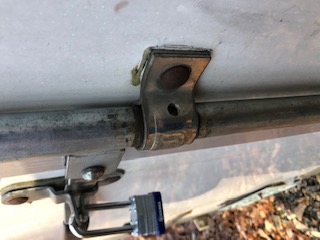

Postby slgrafton » Sat Nov 14, 2020 9:01 am
Because I'm cheap and not a skilled carpenter, I did this.
Also, drilled thru the barn door lock so it can be padlocked in the open position. Dont want any of my jokester friends to get any ideas about locking me in

Postby slgrafton » Sun Nov 22, 2020 4:48 am
kmack67.km wrote:Thanks to all of you for your ideas. My barn doors do have the bar lock on the outer (overlapping) door.
Modstock, I wish I had seen your door lock configuration before I bought my trailer. That looks like exactly what I need. I am going to give some thought to flipping my bar lock onto the other door and adding either an RV door latch or one like slgrafton's. I am only hesitating because the switch will leave about a dozen surplus holes in the outer door that will need to be sealed up somehow.
slgrafton: I wonder if your friends went to school with my friends. If I gave them the opportunity, it would only be a matter of time before my friends locked me in as well.
Thanks again everyone,
Kevin
Kevin, yes I can close the door completely with the bar locked in the open position. Although there is some sag to the door and it rubs on the bottom "sash".
