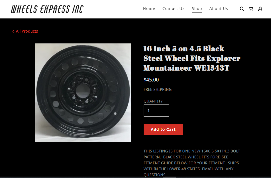

Postby working on it » Tue Jan 26, 2021 9:40 am
16inch, 5 on 4.5- same as 114.3mm, bolt circle wheel.PNG (222.56 KiB) Viewed 1171 times
