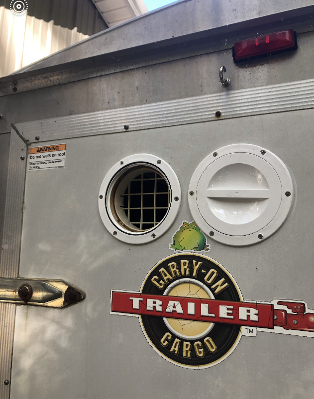

Postby onehoser » Mon Feb 08, 2021 12:49 pm
i ended up using a 5,200 btu window shaker

Postby ISOTNT » Mon Feb 08, 2021 8:58 pm
Oh man, onehoser, I hate to ask but do you have more pics showing the build and install in your trailer? From the outside, I mean?
Also, do you have issues with it being mounted at floor level? This looks like it has real potential for mine as I can't really add the roof refrigerator vent like Flboy and still fit under my awning.

Re: Anyone tried a DUAL HOSE portable AC in a CTC?
Postby onehoser » Tue Feb 09, 2021 6:26 am
iImage
i vented through the floor, this is the best pic i have at the moment.

Postby hankaye » Tue Feb 09, 2021 9:04 am
onehoser, Howdy;
How do you keep the Weather and vermin out? Gonna get a lot of tire spray
when the roads are wet. Just curious.
