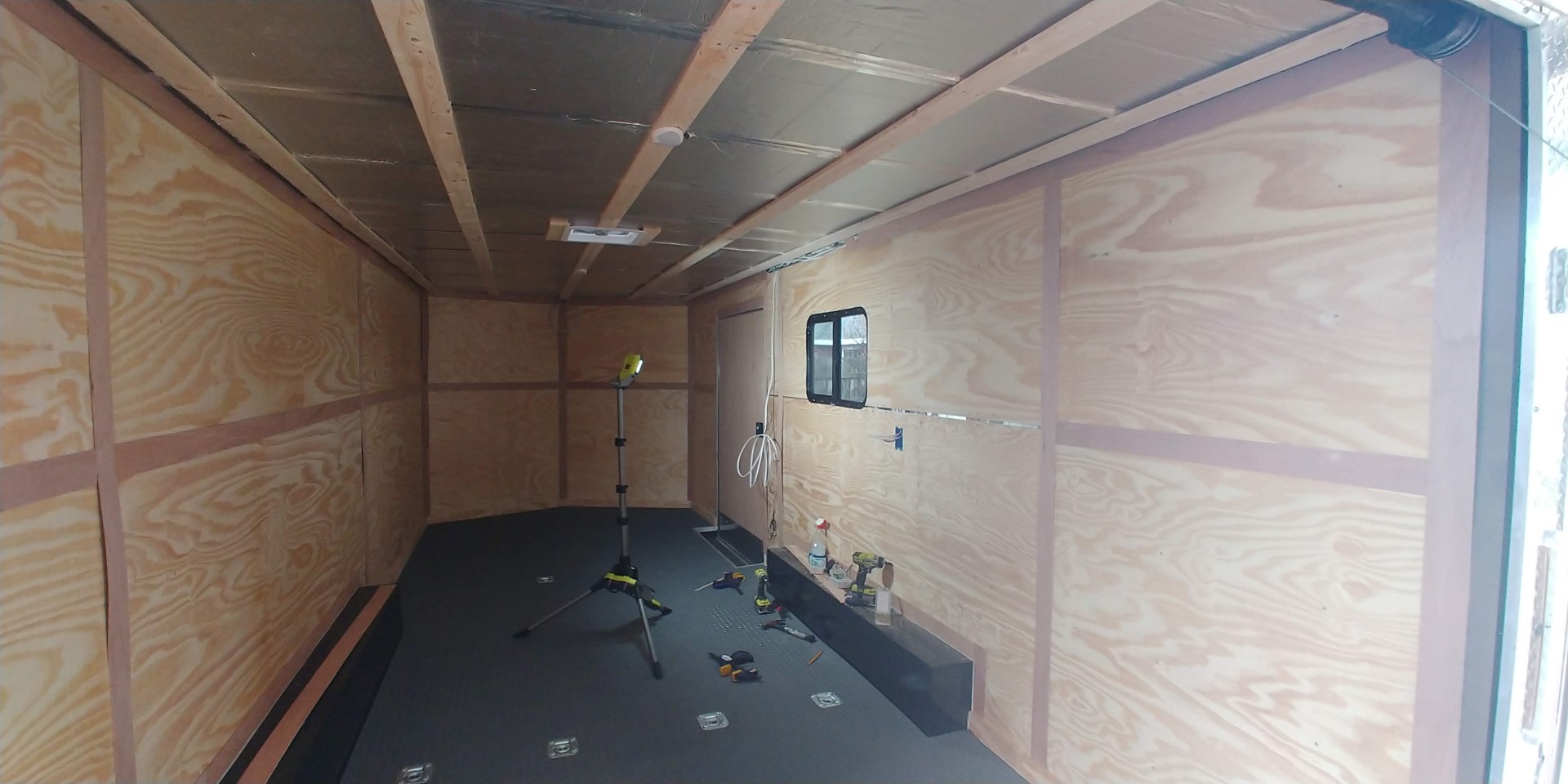

Home from the lot and the cleanest it will likely ever be again.
164339
Insulated the roof and then started on the wall panel removal.
The hell nails nearly killed me. I made it a goal to get one panel done and day during lunch or after work and I usually did, but doing that without destroying them nearly destroyed me!

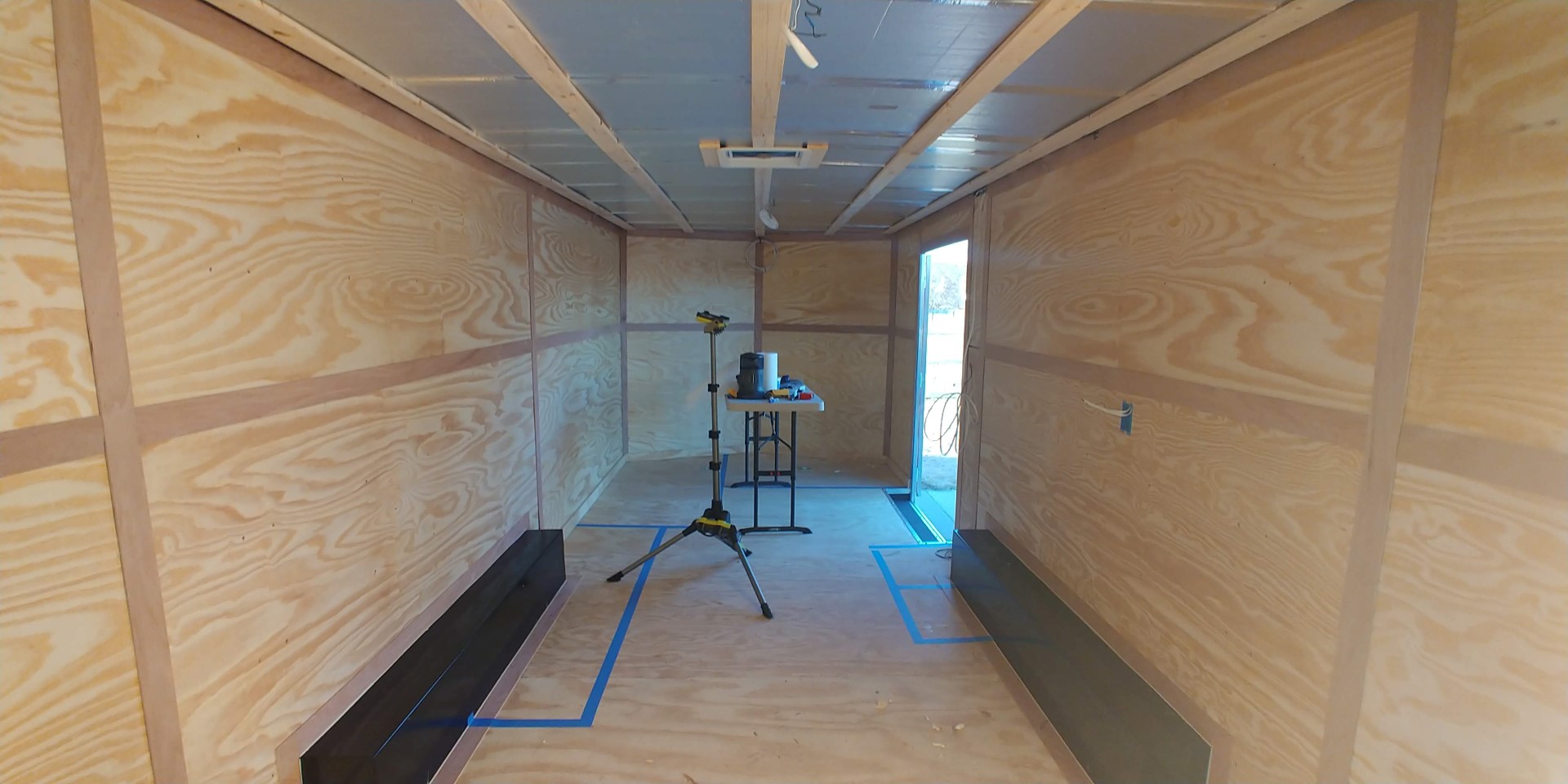

164342
Masking tape layout to get Wife and Kids approval of design with bathroom and their bunks in the front.
164343
Finally got the insulation done and the walls back on with proper screws.
20210223_174431 (Large).jpg (264.96 KiB) Viewed 1131 times

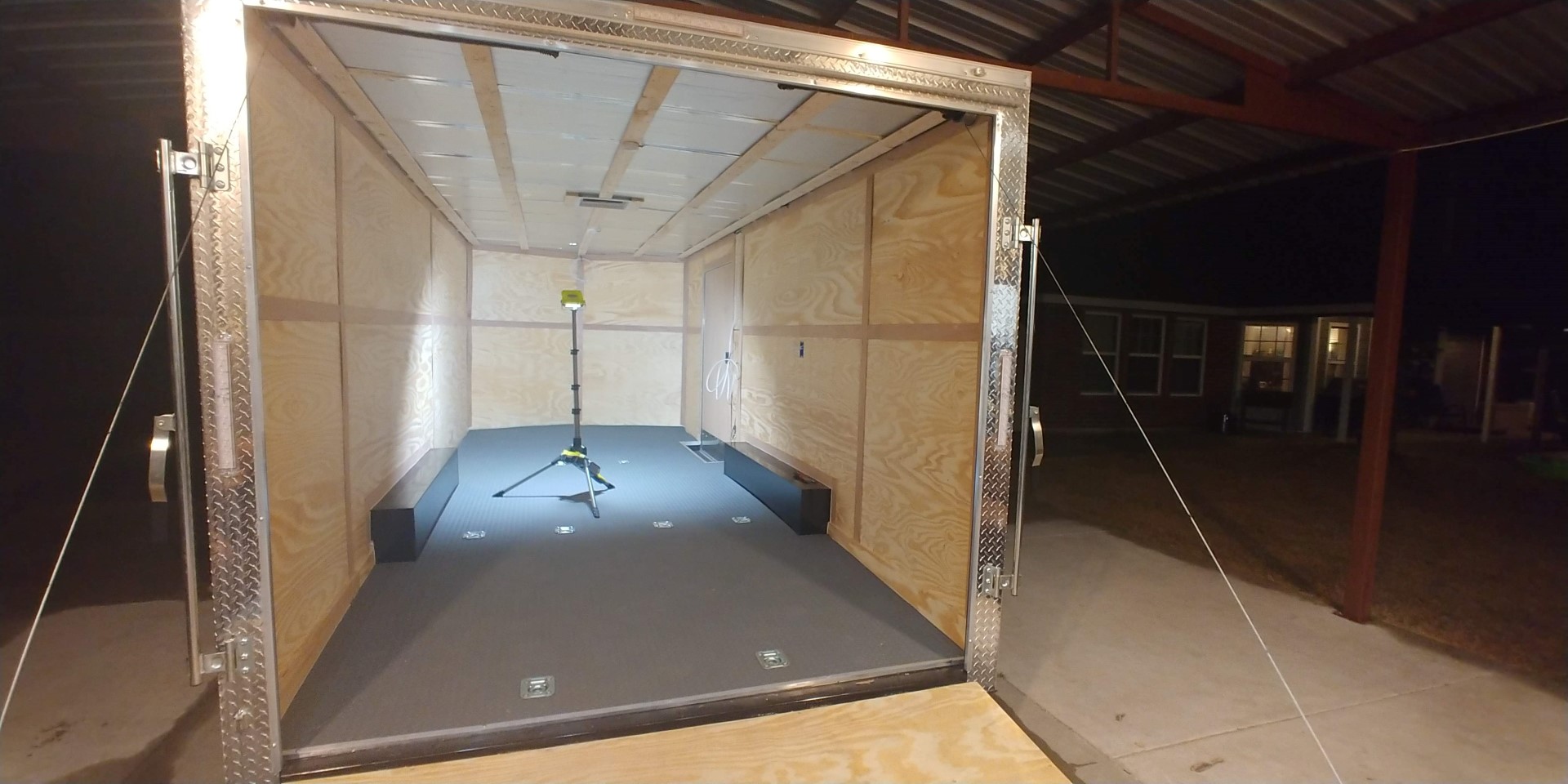

Gray diamondplate rubber floor installed as well as anchors where I need them for the bikes and the ATV.
20210225_193701 (Large).jpg (296.72 KiB) Viewed 1131 times

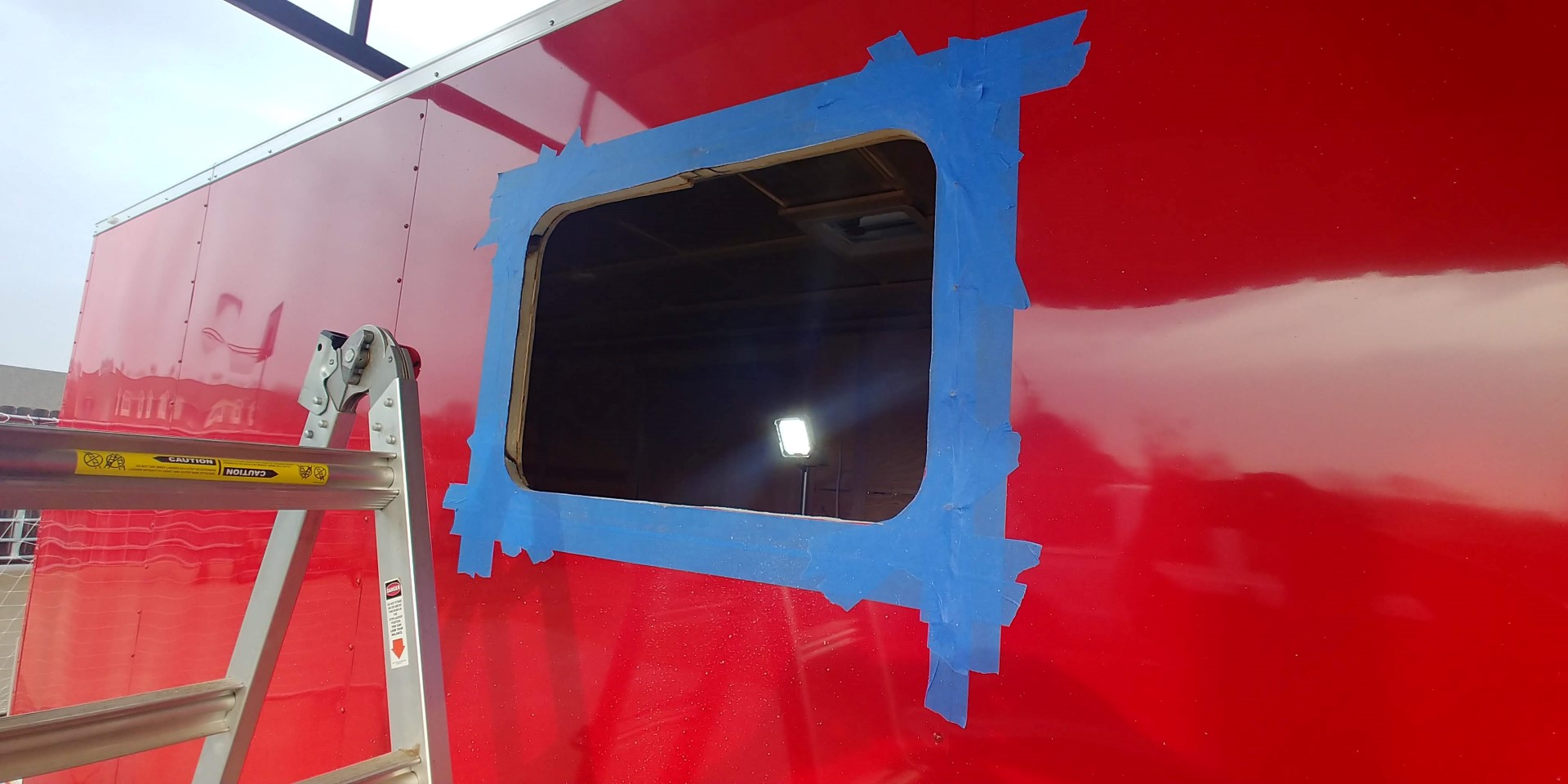

Very nervous installing the windows, but it wasn't as bad as I expected.
20210227_154254 (Large).jpg (303.62 KiB) Viewed 1126 times

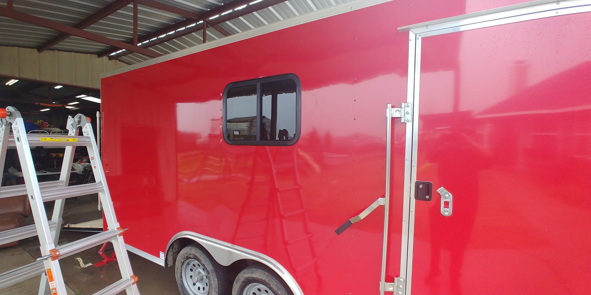

20210227_154238 (Large).jpg (263.73 KiB) Viewed 1126 times
20210227_165450_HDR (Large).jpg (239.3 KiB) Viewed 1126 times
