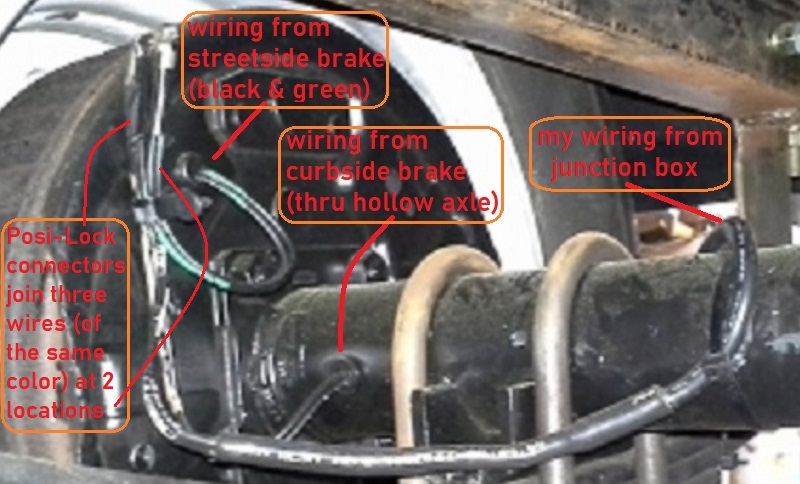

* There should be two wires from each brake, two different colors (mine were), and two similar wires running back from your trailer's junction box. Join up the like colors and you're good to go. Any crimped or soldered connector will suffice (I've seen wire nuts used for this...the large silicone filled ones). I used Posi-Locks (wrapped in silicone tape) to connect mine.
