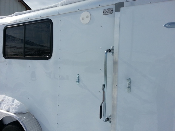

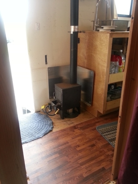

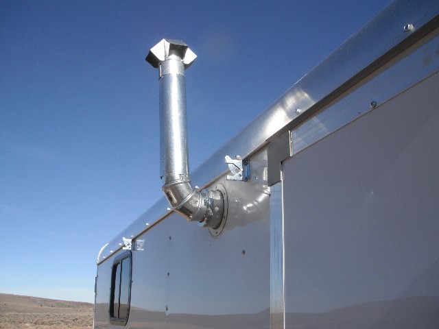

I used a 4 inch marine deck plate as a pass through for my propane stove. The port is just to the left of the door in this picture.
And these are a couple of pictures from my first CT where I used the same stove.

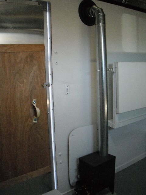

Everything is pretty much the same in my current build except that I use a different pipe cap, and I piped an air input to the stove. The stove is a Nuway propane 2000. https://nuwaystove.com/product/model-2000/
Here it is in my 7x16 CT. The picture was taken during the build process, so cabinets and floor etc are unfinished.

Thank you for the pics of your exhaust piping through the wall.
I like that, much cleaner looking .
