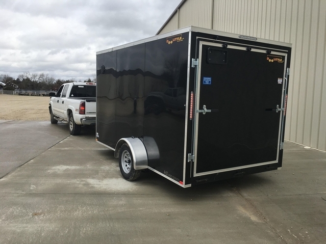

I did some research, and decided to try and find something from wells cargo, interstate, haulmark, etc. Then I stumble across a semi local place that was selling doolittle trailers. Doolittle is a Missouri company that makes all types of trailers. Since they were so close, and they had good prices, I decided to check them out...
I really like the face they had an RV style side door (I think most companies are going to that.) I always like the exterior was mostly screwless. The walls were square 1" tubing, the frame looked good and solid. The walls had 3/8 inch ply wood, but the floor was 3/4" osb, which I didn't really care for.
Overall, I liked trailer, and the price was right, so I drug it home with me.

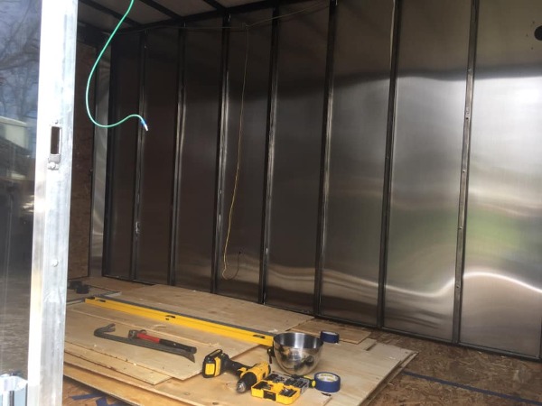

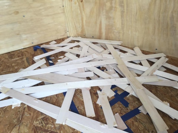

After getting the camper home, I went straight to work pulling off the walls so I could insulate them...
The first step was removing the trim, which I think was 1/8th lauan board cut into strips... I didn't plan on reusing it, so I wasn't very delicate when I removed it... lol

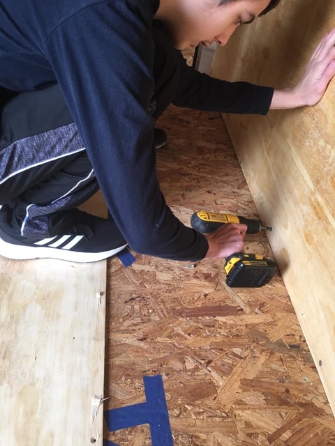

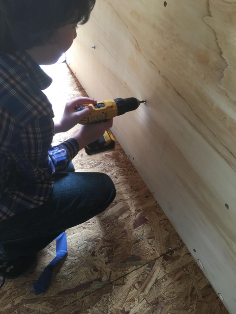

I wasn't going to do all the work myself, so I got the kids involved. The oldest boy is 15, almost 16... and the youngest is 8... First time either one has operated a drill, both did really well...

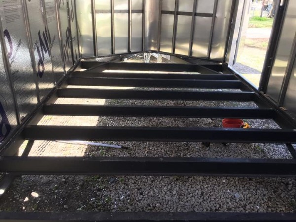

Re: My 7x12 build. Building what I couldn't buy.
Postby BruiserCruiser » Wed Mar 31, 2021 11:55 am
As I was insulating, the OSB flooring was really bothering me.... :thinking: The next thing I know, I'm ripping it out too...
Overall, I was pretty happy with the construction of the frame and walls! :applause:
Last edited by BruiserCruiser on Tue Apr 06, 2021 7:11 pm, edited 1 time in total.

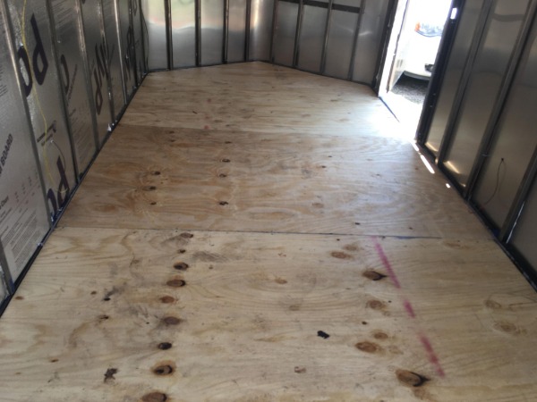

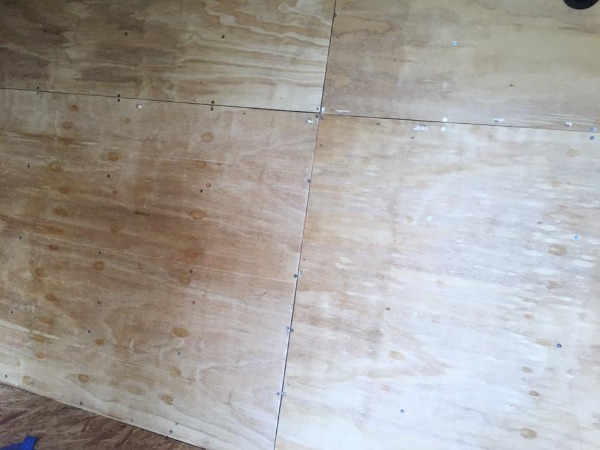

I painted one side of the plywood, and then install the painted side down...
After putting the plywood down, I painted the top of it too.. because why not?

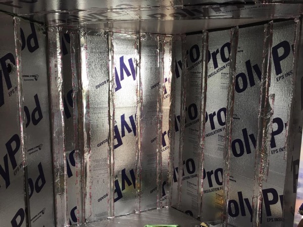

I'm mostly done with the insulation... It's 1" foam with the reflective stuff on one side, I choose to put it facing out... I'm also taping every single seem with some alum. tape stuff my cousin gave me (hey, it was free.)

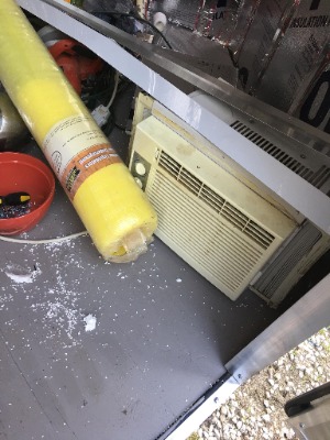

While I was out there pick them up, we got to talking about the camper. He asked if I wanted some free snap together "wood" vinyl flooring, he said it was new and still in the boxes... Heck yes, I like free stuff. As we're loading up the flooring, he asked if I wanted a little window a/c unit. It was a bit older, but still worked great... So we loaded that up to... He also gave me 4 new 4x8 sheets of bead board, and one new sheet of lauan. He also gave me enough wiring to do the 110v wiring, and enough to do the 12v side as well...

This is the flooring I got... Not my absolute favorite, but I like it.
This is the a/c unit. Kind of older, but if it works it works. It'll be inside a cabinet, I'll probably pop the front cover off and paint it black to freshen it up.
