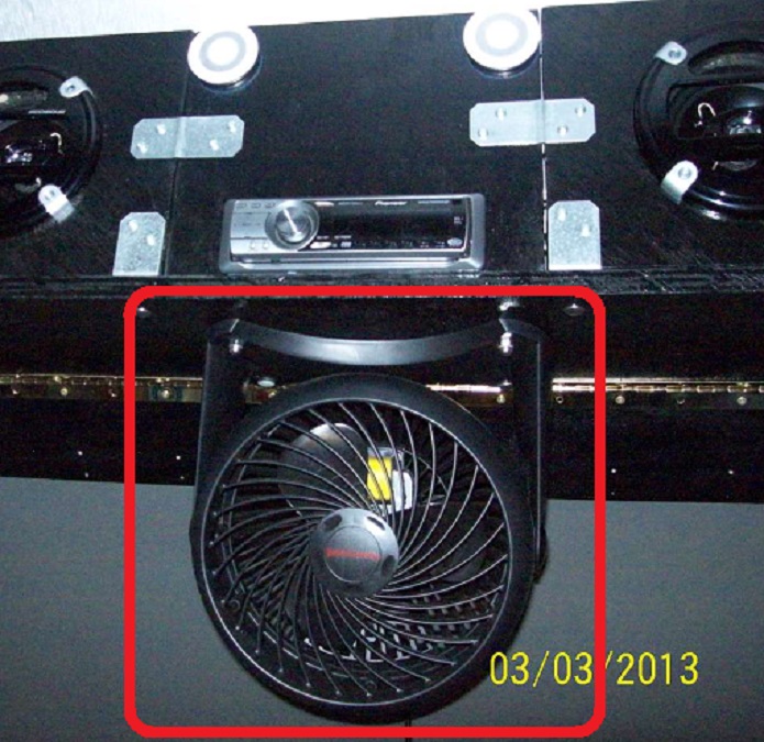

* Living in N. Texas, camping in Texas and Oklahoma, makes using A/C, 110vac fans (both off of parkpower or generator), and/or 12vdc-powerwd case fans very important. The usual temp range is 60f-110f, in March thru September.
* When I started building the trailer. I wanted to use heavy-duty hardware, industrial-look (trucking...I ran shipping/receiving depts, for years) parts, and perhaps re-purposed automotive parts (50+ years of automotive shade-tree mechanics, + 20+ years of drag racing...lotsa parts still lying around).
* I used rooftop vents (mounted on the sidewalls) from semi-trailers, and tried using some radiator fans for cooling, placed over the vents and one free-hanging. The vents worked great, but the radiator fans did not (in tests), much too loud/draw too many amps in such a small space (4x8 trailers are tight...), so I used a tabletop house fan mounted under the front shelf, and two 120mm computer case fans on swingaway mounts over the side vents. Mine only draw .18 ah, and push/pull 67 cfm.The 110vac main fan only uses 3 amps, so if I had to, I could use it via my inverter.
* And then there's the two awning windows, which I can use on cooler nights or in the rain; but using the A/C in 85f+ nights is normal for me.
