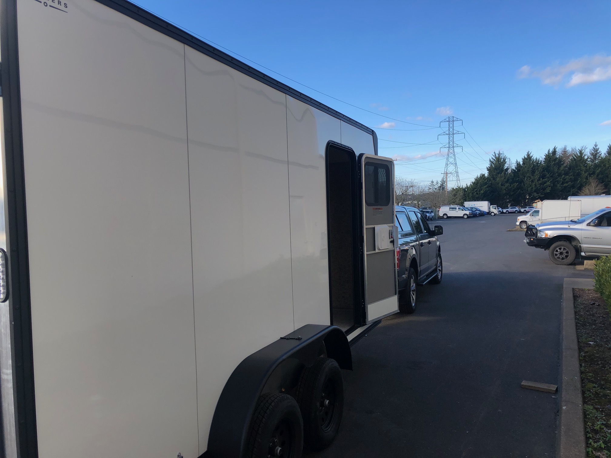

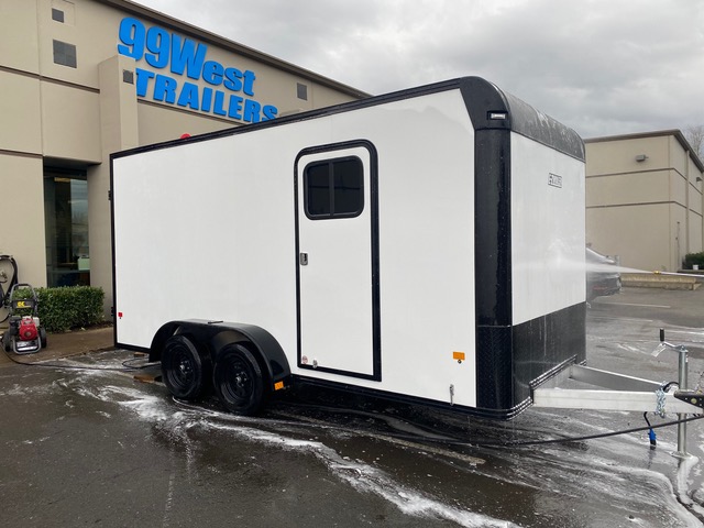

Hi all - Jumping in with both feet, thanks a lot in part to all of the great information and support on this site. After a year of looking at the various travel trailer options available and seeing nothing that met what we wanted (not to mention the build quality for the $$), I stumbled upon this forum and now am the proud owner of a 7x16 EZ Hauler. I added a few custom items to the build, so I've had 9 weeks to diagram, stress, buy stuff, ask a bunch of electrical questions, and re-configure the layout. Now that we have it, I'll be working through the usual first steps of insulation, roof vents, windows, wiring, and interior walls/ceiling steps. I'll try to post pictures along the way.
Trailer:
7x16x7 Flat Front EZ Hauler
16" O/C walls/ceiling
RV door with window
axle flip
Cargo doors
rear stabilizers
Goals
1) Make it comfortable for my small family so I have camping companions
2) Build with good quality materials so it hopefully lasts a long time
3) Learn along the way, and get my build helper (5 y/o daughter) involved as much as possible
Layout will be bunks up front, queen over the axles, bathroom in the middle on the passenger side, with galley in the back with pull-out drawers that slide under the bed.
Photo from dealer
First Photo
