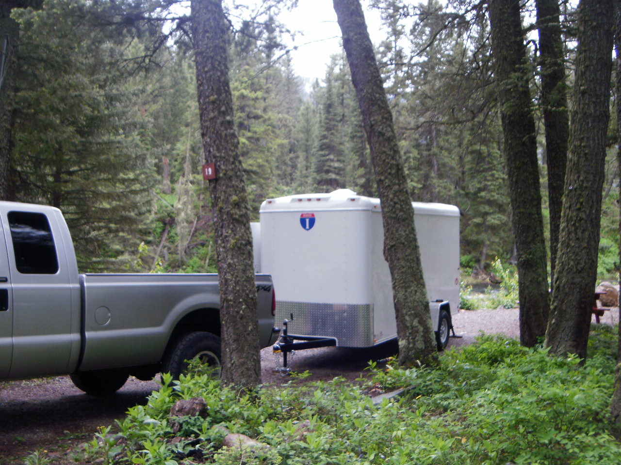

I kinda split the difference. I have a 6X14 single axel. Tow it with a 2004 F-250 (6.0 diesel, 8' bed, w/4wd),
Mine has the slightly rounded 'Flat' nose. Hardly know it's back there. Get's me around the Gila Wilderness
Forest Service Roads well.
This was in West Yellowstone
hank
