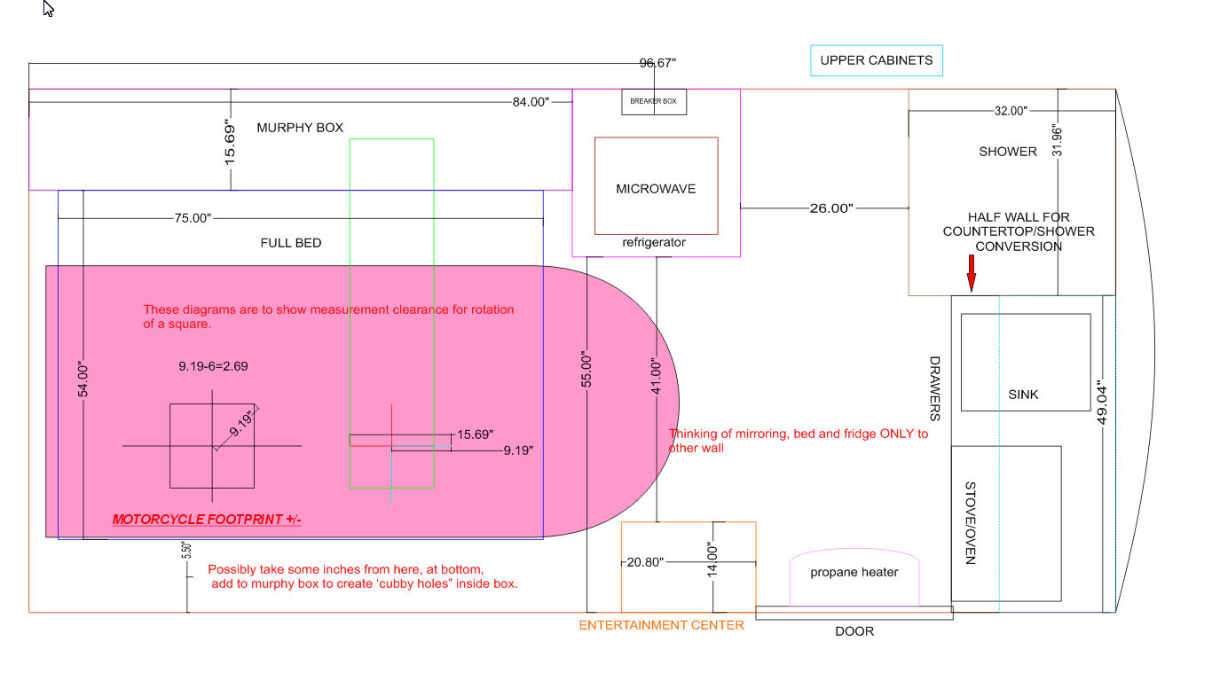

Postby Hotrod70 » Sat May 29, 2021 11:01 am
That is great news. I look forward to seeing your build completed as well. I have had a lot of prep work but I could not walk away from the price.
This is my floor plan at the moment
