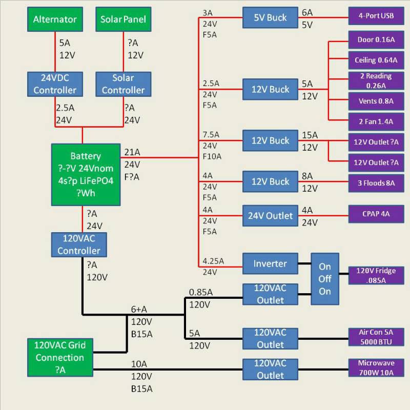

Postby rebelrider.mike » Sun Jul 25, 2021 7:57 am
I was thinking about how much power I would need from an electrical hook up at a campsite, and I realized I have no idea what they provide. I've only ever been a tent camper. I looked around briefly on the net, and found that campsites might offer 120VAC 20A, 120VAC 30A, or 240AC 50A.
Are those pretty standard? Should I build a system that could use any of them?
I'll keep searching and reading, but advice is certainly welcome.
I've been adding up all the stuff I'd like in the trailer and made a schematic of how I might do the wiring. It's not conventional, so it might be hard to read, but it gives me an idea about how much power I'll actually need. It's a work in progress, as I don't have all the information yet, but here it is so far:
I guess I should ground the trailer body to the grid hook up too. I wonder if that will be an issue with the running lights, since they're grounded through the trailer back to the truck's battery. I need to do more reading...

Postby flboy » Sun Jul 25, 2021 10:41 am
Any particular reason for the 24VDC battery bank? Seems you are adding a level of complexity with the Buck converters and etc. not needed. A 24VDC battery Bank may be advantageous if you were running a huge inverter and were trying to minimize line loss from Battery to Inverter. You can minimize that if you just put the inverter as close to the bank as possible. In any case, you can run a 24VDC Solar array into the 12VDC battery Bank. The Solar Charger will handle to conversion and charging.
On the campgrounds, just carry a 50A to 30A adapter and a 30A to 20A adapter an you will have your bases covered. Most will have all three, but I have run into situations where there were no 20A and I use 20A.
Good luck with your build.

Postby rebelrider.mike » Mon Jul 26, 2021 1:42 am
Thanks for the links Hankaye! Lots of information there. I haven't read it all yet, but now I'm definitely grounding the trailer body.
I'm using a higher voltage battery for a couple reasons. The main one is so that the battery will always have a higher voltage than all the 12V stuff. So the buck converters will always be able to keep the LED lights and fans at a constant 12V, which would keep them running at the same brightness or speed all the time. The other reason is that I might be using a solar charge controller that boosts the voltage instead of bucking it like most controllers do. An odd little machine, but it's programmable, and has a nice little screen that provides tons of info, and can work with many battery chemistries. Anyway, I want to try it out a bit before deciding if I'll actually use it.
My CPAP can work between 9V-30V, so it won't need a converter, and the USB ports would need one anyway. Though now you've got me thinking, I realize that the inverter won't run on 24V. It's designed for 12V. I'll either have to find an inverter with the right voltage range, or get a buck converter for it too. That's going to either be a lot more expensive, or I'm going to lose more efficiency by converting things twice. Well bugger. More details to figure out, LOL.

Postby flboy » Mon Jul 26, 2021 6:25 am
If you use a Lithium Battery Bank, the discharge curve is very flat so you should not see any discernable fluctuations in LED brightness or fan speeds. I've never noticed anything like that.
