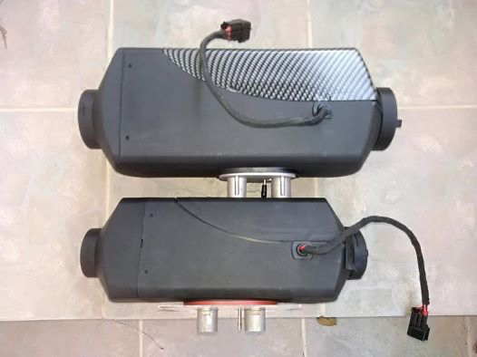

Postby featherliteCT1 » Tue Dec 14, 2021 5:37 pm
diesel heaters.png (240.18 KiB) Viewed 2796 times
The 5k model shown in the top of the photo is slightly larger and has offset ports.
The 2k model is shown in the bottom of the photo.
My understanding is that 2k models are very hard to come by and that most of the models advertised as 2k (or 7k) are, in fact, 5k models. I would never detune my Chinese 5k model due to risk of poor combustion and increased risk of soot build up. I have been running my Chinese 5k model on straight kerosene for three years running with the unit tuned to OEM specs resulting in zero soot build up. My understanding is that virtually all of the problems experienced with these heaters is due to not installing and tuning the units strictly in accordance with the instructions or installation without having read the instructions.
The 5k model on the lowest setting will produce more heat than you can handle. However, the good news is that the problem is easily solved by opening a window, which is a good thing because the fresh air is nice.
PS: The cheap plastic fuel containers are notoriously prone to failure (usually splitting at the seam(s)), especially if exposed to UV rays.
