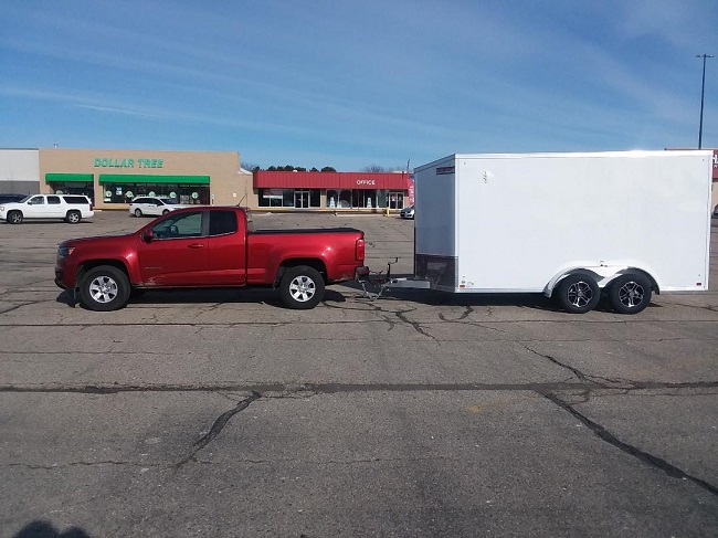

So, I purchased an all aluminum 7x14 trailer. I bought aluminum since I tow with a 4cyl truck. Truck tow capacity is 3500lbs. Trailer weight is only 1400lbs empty. I intend to build inside as light as possible. Using think aircraft, not tank with the interior structures. I should finish out with a good margin under the trucks tow capacity.

Cindy and I name our vehicles. She saw the photo's of the new big box of a trailer. First thing she asked was what will will call it? Told her I had it figured right away. It's a white trailer. How could two Breaking Bad fan's not call it Walter? Walter White it is.
