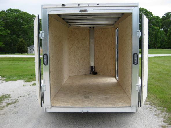

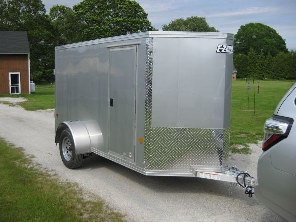

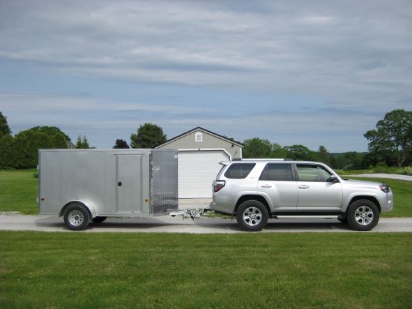

The trailer I ordered built is tailored to my tow vehicle—a 2021 Toyota 4Runner SR5 (V6, 4X4, 4940 lbs empty, 5000 lbs max towing capacity). I am determined to limit the packed-and-ready-to-roll weight of this camper to 50% of my vehicle’s towing capacity—2500lbs—and to have its aerodynamic footprint be as close to that of the 4Runner alone as possible. I'm happy to answer any question about what I've done already.
1. Tow Vehicle—2021 Toyota 4Runner SR5; added Redarc Tow Pro Elite brake controller; OBDII Scan Gauge to monitor transmission temp; may add air bags if rear squats too much
2. Trailer—2022 Ez-Hauler 5X10 aluminum; electric brakes added; upgrade to 3/8” OSB from luan; extended electrical cord by 3 feet to compensate for 4Runner’s offset plug receptacle; deleted wall vents; interior height 64”; interior width 57”; interior length just short of 12 feet counting v-nose; double barn doors; 890 lbs total weight, 130 lbs tongue weight, as confirmed at CAT commercial scale

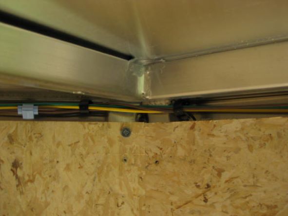

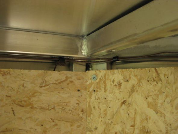

My trailer has a gap at the top of the walls hidden by aluminum panels, now removed, to make wiring easier, I assume. The wiring and wiring fixtures will be in the way when I fill that gap when finishing the walls. Any thoughts on how best to deal with this?

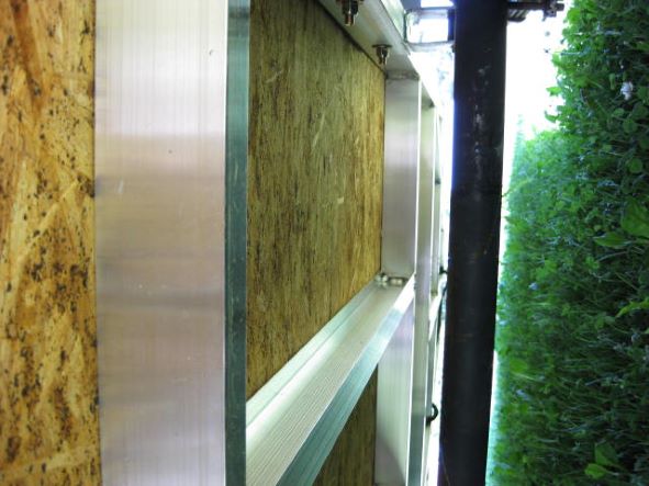

Am I correct in assuming that after I remove the osb wall sheathing the structural integrity of the trailer will be compromised and I should not use the trailer on the road for hauling until the osb sheathing is back in place?

I've read where different people have been told not to remove the plywood or OSB, because it changes the integrity of the trailer. I could see where it might some. In the framing of my trailer, there is no cross supports, either horizontal or diagonal between the metal studs..

On the gap above the walls, use a piece of trim to your liking, to cover up the gap when finishing the walls.. of course being careful not to nail or screw through the wires.. my trim will be attached so it can be removed incase I need to ever rundown or fix a short in the wiring..

Thanks very much for the info, David. I'll look into the Zinnser primer. The gap at the top of my walls may turn out to be a benefit, not a problem as I first thought. Fitting a plastic C-channel in the gap and then running the same channel down inside both walls to outlet level may be just the ticket. I've got to work out my electrical needs asap.
