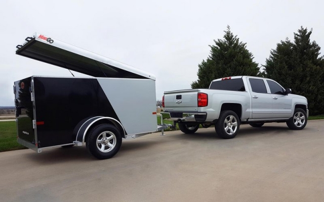

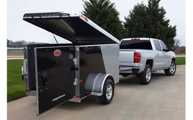

I have always had a dream of converting one of these for a "pop-top" conversion.
I haven't priced them, but this is a first-class, top-quality manufacturer so I'm sure they are quite spendy!
http://www.sundownertrailer.com/tlr-MiniGO.html

aggie79 wrote:I have always had a dream of converting one of these for a "pop-top" conversion.
Oh my!!.... you and I both ! These would make an excellent base to build on. Low tow height, light weight, so, so much good about them, but.....
They have one problem. TOO NARROW for me.
They should make a 6.5' wide, with flushed wheels. I guess even if they never built a 6+ wide, I'd still take one of these over a teardrop.
A guy could convert it from the single hinged end to a full, straight up lift concept pretty easy. I'd dump the swing door, turn it into a ramp so I could just make it an elevated floor, then sew up an enclosure that encompasses the entire available floor space.
I looked pretty hard at these before I went with a regular 6x12. Trouble was it was more expensive than my 6x12. Awesome looking though.
