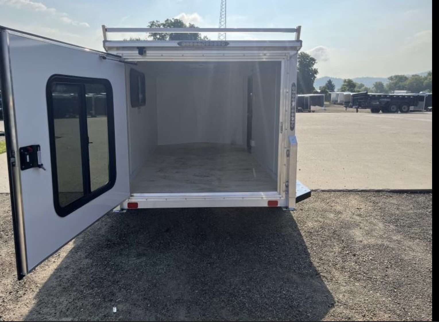

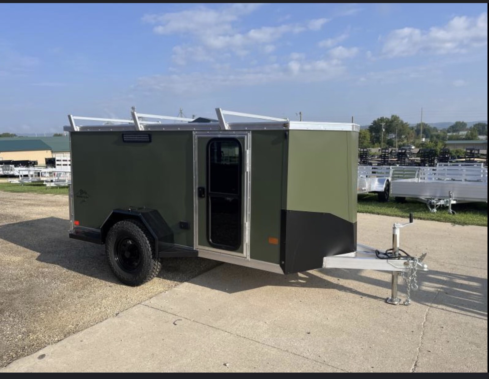

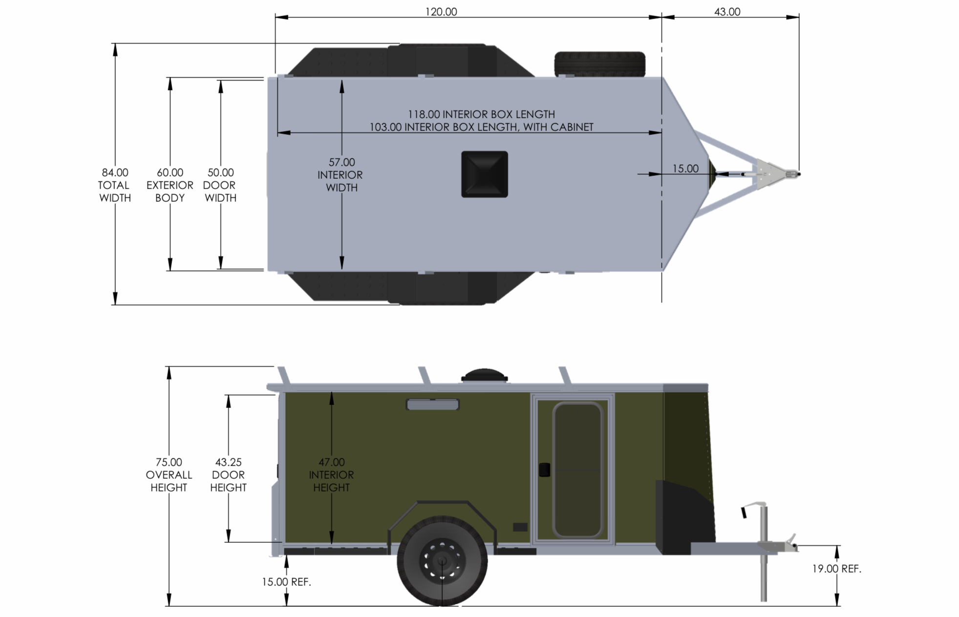

Just purchased. Looking forward to adding the comforts of home

I sure like the frame integrated tongue rather than hanging the tongue a-frame under the trailer frame methods. Looks like a rigid little bugger.

I just bought a 14x7.5 Neo and I’m happy overall with the build quality but they screwed, glued and caulked the interior panels. This makes removing them to insulate impossible without damaging them.

Have you already started removing the panels? if not, they may already be insulated. They do have packages that includes insulating. You can give them a call or email them, they are really good about getting back to you with any questions.
I have a 2019 NAMR 7x16 model; I ordered mine with no interior as I planned on finishing it out myself.

Interesting. I have not started taking it apart however the temp of the interior walls on the sunny side makes it very unlikely. I will check though
