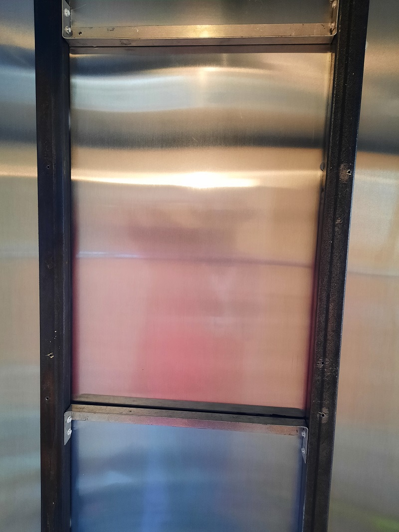

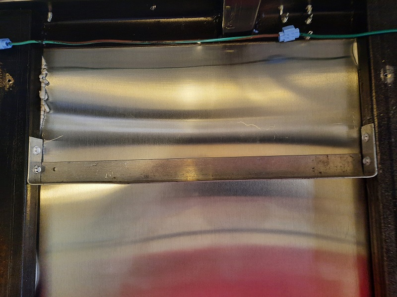

Well, thanks in part to the insightful comments here, and, my own curiosity as to what really "lies beneath" I am taking off all the plywood. Very revealing!! Some good...some not so much. The welds and the spacing of the metal 1X1.5 studs looks good, but...there is VERY little paint on the parts that you can't see...just the paint on the top portion that you can see with the plywood on! So...once again I am glad I referred to the many voices of experience here. I have even decided that the 3/8" plywood with all it's lopsided placements will be replaced with some nice pre-finished wall paneling. A little pricey, but no priming and painting 2 coats to cover the rough surface. And...I can use the plywood for the bed tops...the shelves...and who knows what all else. HD has a paneling that looks like old barn boards. Will see it in person before deciding, but I really like the look. Now...if I can figure out what to put up as a ceiling??? Maybe just 1/4" plywood with ceiling paint...Nuthin' Fancy, but should do the trick.
I started on the window cut-outs today. I made my own top and bottom supports from some re-used 1" aluminum angle I had laying around. I will post a pic if I can figure out how. I am using very basic "shed" windows so please go easy on me. They fit exactly in between the studs. I will apply some butyl tape, use the white 8 point screws I found on Amazon, then trim off the excess. I will follow that up with a nice bead of white caulk just to be sure it is sealed. They are 14X21 and with 4 of them in, we should have enough air flow. I may do a 12X12 in the door, just to look out of, but I really would like to know how it is made before I get into that. It is white metal on the outside, shiny aluminum inside, and when you tap it it thuds like it is a foam core. Anyone have a similar door that they cut open to put in a window? Would sure like to know before I do.

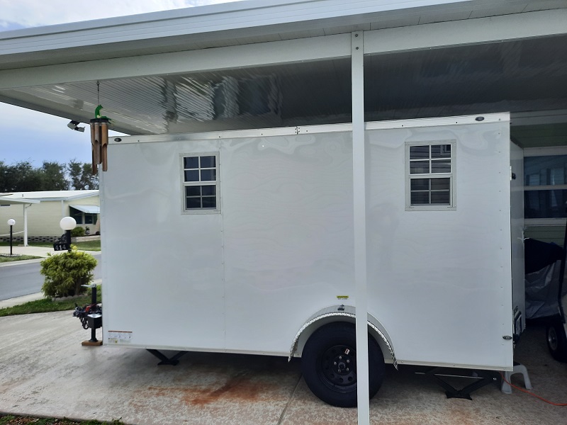

Well, here goes! Outside pics of the windows installed on Driver side and Passenger side. I just ordered a 12X12 non opening window (matching) for peeking out the front door. ALL the plywood is off down to the bare aluminum inside. I caulked all the places where the floor plywood meets (almost that is) the side metal studs. The factory guys did not run it all the way to the edges of the wall studs for some reason. And, in some places they missed the cut enough that I could look down and see the ground! So...needless to say that took some extra caulk!! The can of spray foam did not work (only 6 years old LOL) so I used up all the tubes of caulk I had laying around. I wish it had pressure-treated floor plywood as some use, but I guess I will buy a couple of cans of undercoating spray and do the bottom up real good. That way I will be able to coat the floor joists (nice and stout 2X2 box beams) at the same time. I am also going to try and post the simple top window frame supports I made out of 1X1 aluminum angle. Actually, I only did 2 of the windows with those, and for the other 2 I used some 1X1 square tube aluminum from an old awning I cut down to size. I cut 2 inch aluminum brackets in half to make the mounting clips for those. Worked fine. Too bad the metal 1X1.5" wall studs were not more accurately welded in. Some were OK, but 1 was so much wider I had to put a piece of aluminum bracket there so that my windows would have a solid mounting surface. PAIN! Anyway...on to the insulation, rough wiring, and the inside wall coverings including the ceiling. Then, a rudimentary shelf in the V-nose, and the bed frames. WHEW!! Will post more if I don't fall out first!! It is a little harder when you get past 70 to work a full day without a nap!! And...trying to keep this project on a budget!!

Postby Modstock » Mon Dec 25, 2023 10:17 am
Looks good.
While your in there. Get rid of those scotch-lock fasteners and install some regular butt connectors in the wires. That'll keep the taillights from flickering (shorting out) down the road.

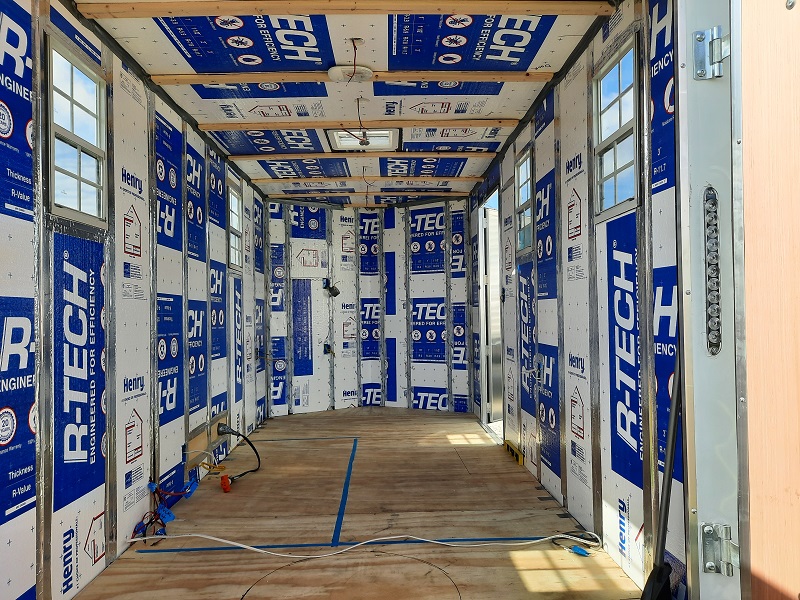

Postby CampingCur » Thu Jan 04, 2024 10:13 pm
Making some progress, although somewhat slowly. The wiring (12 volt and 120) are both in. The insulation is completed. I am now just beginning to make the bed frames. I will set them in temporarily for our next camping trip (mid-month), then see how the other stuff like the fridge, some lightweight drawers, and some hanging storage containers do on a "real" trip. Should be revealing. I have a nice 45 AH lithium battery from our Prius that I will work in the mix, and a 10 amp charger that can keep it fully charged. We will have a plug-in site, but it will be nice to have the 12 volt available for emergencies and such. I did get a outside porch light installed, and after the ceiling is done (still trying to figure out what to use), I will install 5 recessed LED puck lights. Here is a pic of the insulation all installed and the edges all taped. I also ordered a kit that will let me install a fan in the vent without having to remove the existing one. I added a wire up there for when I get ready to hook it up. Hope it is as easy as some reviews say!! We'll see. It was 90 bucks, a lot less than a whole new unit. So...that's all for now. More pics when the beds are in and the wall paneling is up. Any ceiling suggestions are much appreciated. My present thinking is to get some 1/4" or 5MM paneling and have it cut in half to make it easy to get home and lighter to put up. But...I will have to paint it!! More work!!
