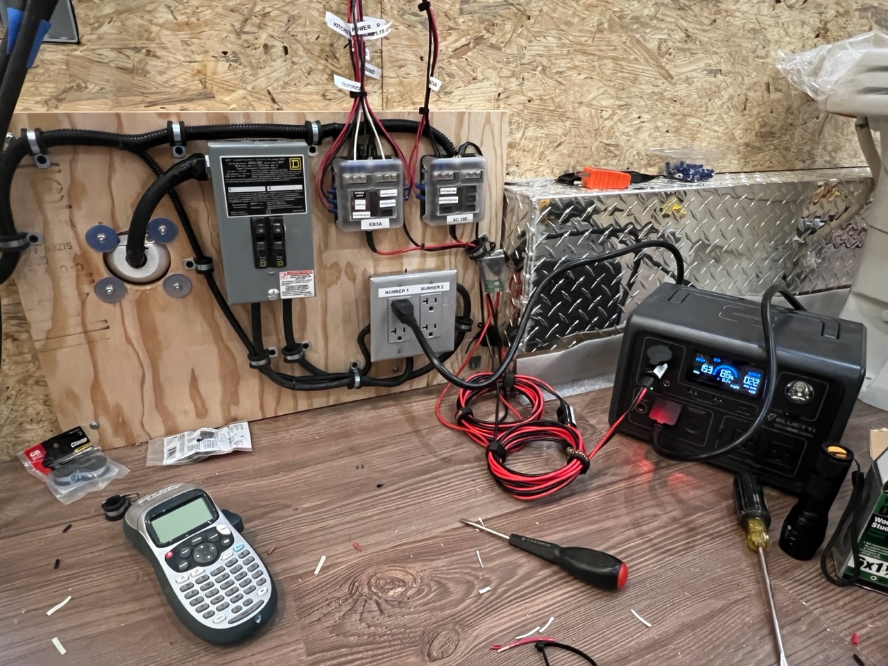

Postby ChrisDiana101 » Thu Aug 08, 2024 4:59 pm
I decided to use a Bluetti AC180 for all of my AC circuits and another Bluetti for all of my DC connections….I have also wired in a 30A shore power/generator connection. I also have solar to help charge the Bluetti’s. If you have any questions, just reach out! I am building a 7.5 X 16 all aluminum cargo trailer.
Take care,
Chris
ChrisDiana101
Posts: 1
Joined: Thu Aug 08, 2024 4:50 pm
Re: Very Simple Electrical
Postby philpom » Thu Aug 08, 2024 9:44 pm
That actually looks complicated to me, but each his own! The ac180 is $1000 each, you have 2 of them so $2000. Of course by all means buy and use anything you want but for about $500 you could have the same capacity (200 ah lithium) of 2X ac180 and be able to swap out the battery when they fade away...
I run the entire camper on a 100 ah lithium battery using dc except I do have a 750 watt inverter for random needs and a 120v port for running the ac/heater from the generator or shore power. I charge using a 20amp charger on shore/generator power or 220 watts of solar. We'll call it super simple.
Your wiring does look supreme, good job!
