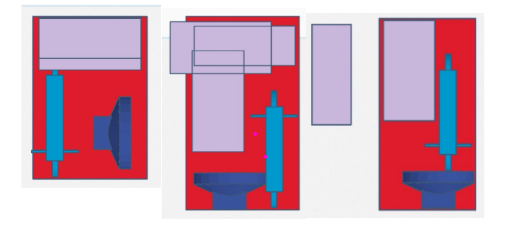

I debated the very same thing and in the end ended up trying to decide between a 6x12 or a 7x12. The extra 2 feet of length give you an additional 12sq feet which is a lot. I have a 425lb bike, a paramotor and wanted a comfortable bed.
The attached image is a twin bed plus motorcycle and paramotor in various sizes of trailers. 7x10, 7x12, and 6x12. The bike model is slightly shorter than my actual bike. So it’s possible to have a bike and bed but it would be tight.

When the question becomes between a 6x12 or a 7x12, you need to understand that if you are still talking single axle, that extra 12 square feet can tempt you into being overweight as you plan to utilize it. Remember, the 7x12 is already more weight than the 6x12, and that 2990lb single axle limit can scream up to you real fast on a conversion... unless you order the trailer with brakes so they tag it at 3500lbs gross. Adding brakes also adds 60 more lbs to a trailer just so you can do the math.
