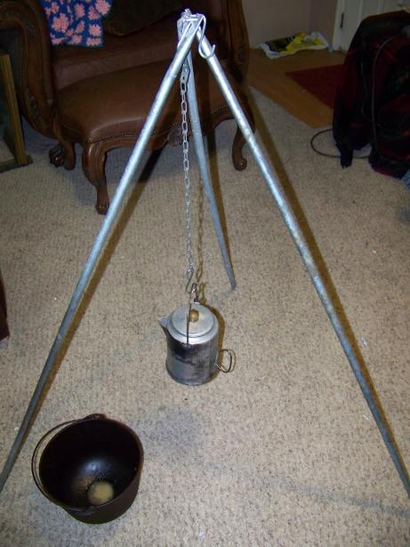

They work for the flat bottom skillets/DO's/etc to help keep them stable and up enuff to put the briquettes/coals under them. I have a bean pot that has the 3 little legs under it, but they are not long enuff for my tastes. I also made a 3 legged tripod-crane for hanging the cast iron stuff from chains over the fire.
It works very well even for my coffeepot. I made the top where it hooks together sloppy so it would level up a bit easier....3 "S"-hooks thru the emt tubing flattened on one end with a drilled hole and then thru each other and bent shut. "S"hooks also support the chain and whatever bail you hook under them..I like cooking my beans outside with that little CI gallon and a half round bottom pot in the tripod picture.

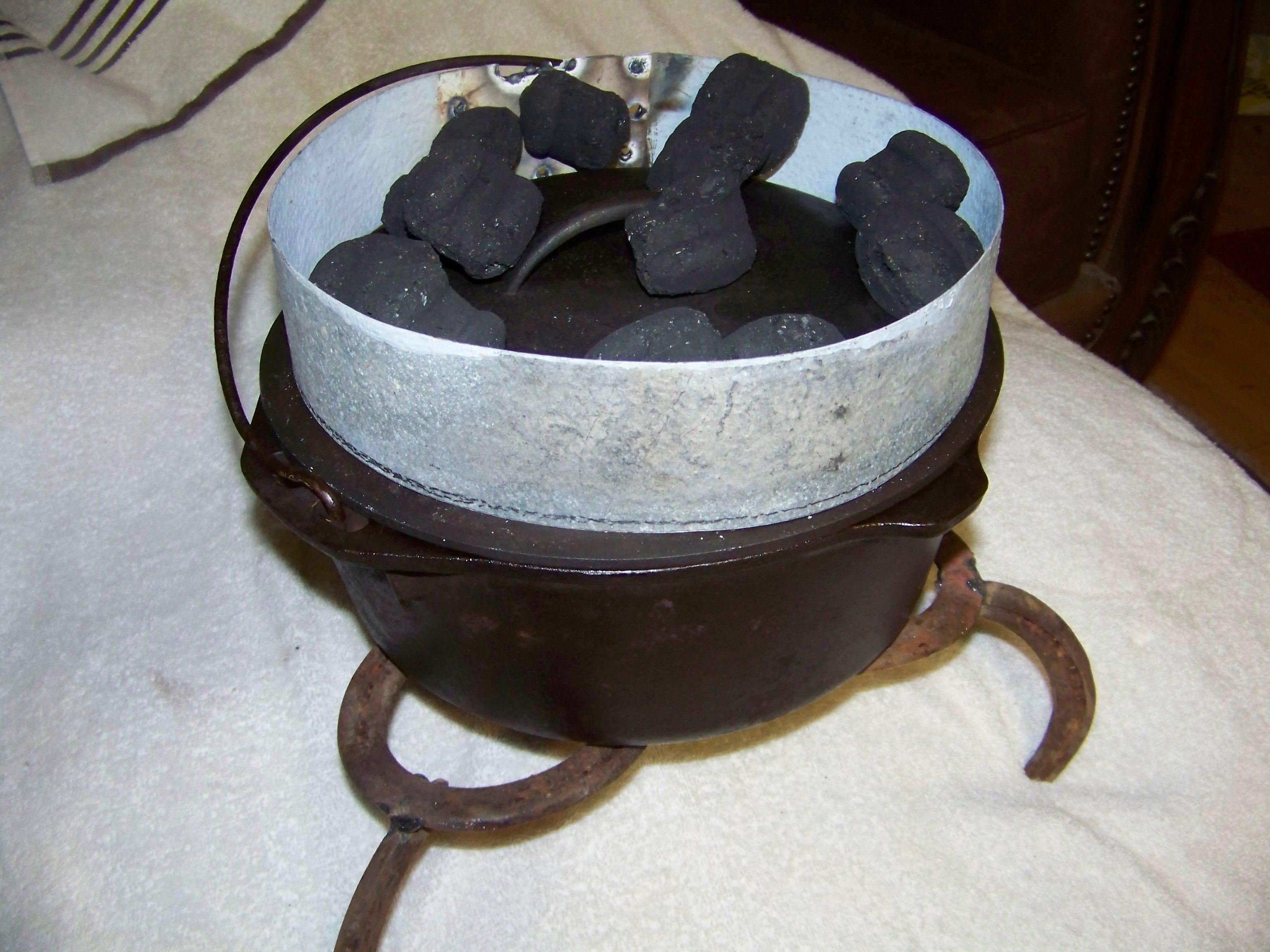

I also make these simple charcoal holders for the cast iron lids without the outside upturned ring.. It's just a simple 1 1/2" to 2" tall sheet metal ring. This one is on a slightly rounded DO lid with the horseshoe trivet legs under it. Nothing new, but it's quite useful.

Thanks CAJUN LADY..... I made myself 2 of those and use one on coals to cook with and one off to the side for a hot lid holder. It really helps keep the lids clean. Specially if there's hot coals on top of it still and you are just checking yer biscuits,,,,or something...lol

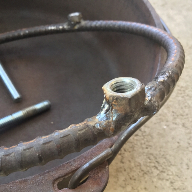

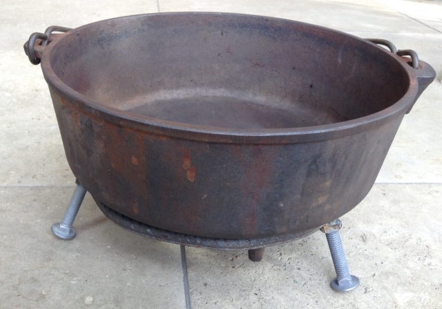

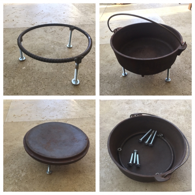

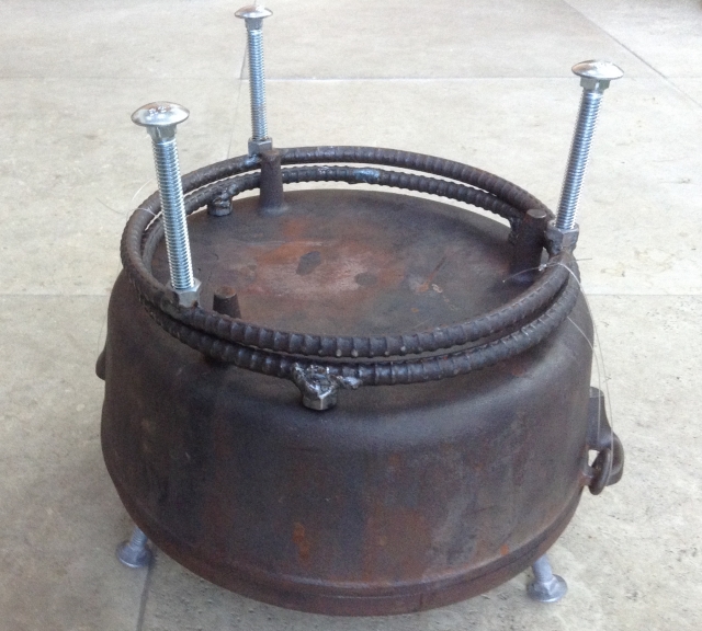

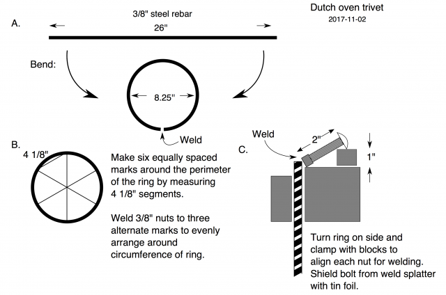

Instead I made a trivet for my 10" dutch oven out of 3/8" rebar.
Some features I found for this design:
  • It disassembles compactly to store several trivets in a single dutch oven.
  • The disassembled ring works as trivet in the dutch oven to elevate small pans from the bottom.
  • The legs are removable bolts and thus may be changed to different lengths (heights).
  • It fits an inverted lid for use as a fry pan.
  • A 12" dutch oven is acceptably stable on it. Other types of pans should fit too.
I made another where the legs splay out a bit that I think looks better and might be even more stable:
Here is how I did it:
Welded 3/8" nut to rebar:
The most difficult part for me was bending the rebar. I bent it cold but I would guess heating with a proper torch or forge would make it easier. My circles were not perfectly round. I think the most important part is to get it fairly flat so the dutch oven does not rock. That is probably not going to make much difference functionally but rocking lacked aesthetic appeal. I used galvanized nuts and screws that should be food safe as long as they are not immersed in acid food. I don't plan to have my food directly contact with the trivet anyway.

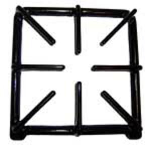

Postby bobhenry » Wed Mar 07, 2018 6:37 am

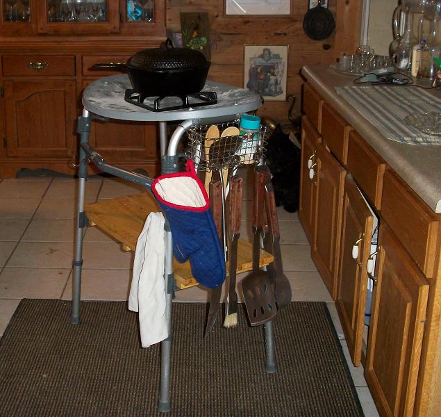

Put your camp lid on the trivet (gas stove grate) smooth side up ( handle down) . Place your makin's on the lid and invert a skillet also placed upside down . (The lid should fit the skillet ). Add your coals to the bottom of the now upside down skillet as well as a few under the lid. The shallower skillet allows the heat to be a bit closer to the food for a much crispier crust. I wait till the last 4-5 minutes before I add the cheese topping so it will not over cook. If you are worried about burning the crust place a single layer of parchment paper between the lid and the crust.
Hint: diameter of the skillet times two for a coal count and place 3/4 of them on the skillet and 1/4 under the lid.
