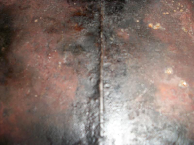

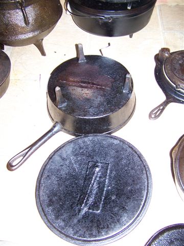

Having on a couple of occasions done some some sand casting of aluminum I would think the lid would need to be pored on edge. Looking at the lift handle there should be a small spine running the length of the handle where the top and bottom sand molds were joined
The handle would be 1/2 in the top and 1/2 in the bottom mold there would be no other way to cast the loop handle in a sand mold. Therefore the pour gate would be a small ground spot on the edge of the lid.

Rock wrote:I'm certainly no expert but I'd like to see a pic of a camp DO with the gate on the bottom. I've never seen one though I haven't Googled it. It's possible the lid and bottom are different ages, or that it was made in a transitional period where the manufacturer felt that a gate on the bottom of the pot was no big deal, and edge gated the lid and either filed or ground the gate mark off. Dunno. Just speculating. Hopefully someone knowledgable will chime in.
Eric
Here is your gate mark on an ancient skillet

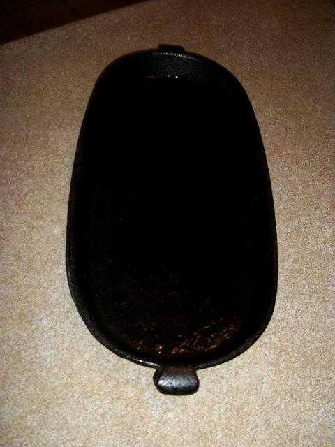

Here is a 120 year old griddle ? biscuit pan ?? whatever showing the mold mark indicating it was poured on its side

Discussion hints that mid 1800 to very early 1900 most castings were bottom pour gates.
Later they were side pour gates. The side pours left a raised band just below the centerline as the pot sets upright.
