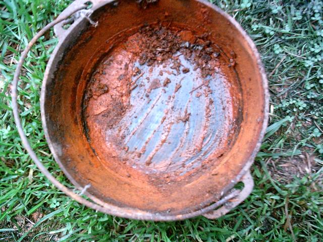

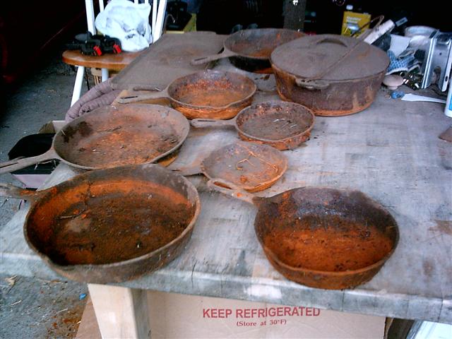

Postby Eunice » Thu Nov 08, 2007 12:36 pm
It is taking time but here is a couple of pictures. This is when I got them. I will post more pics after the first cleaning/seasoning later.

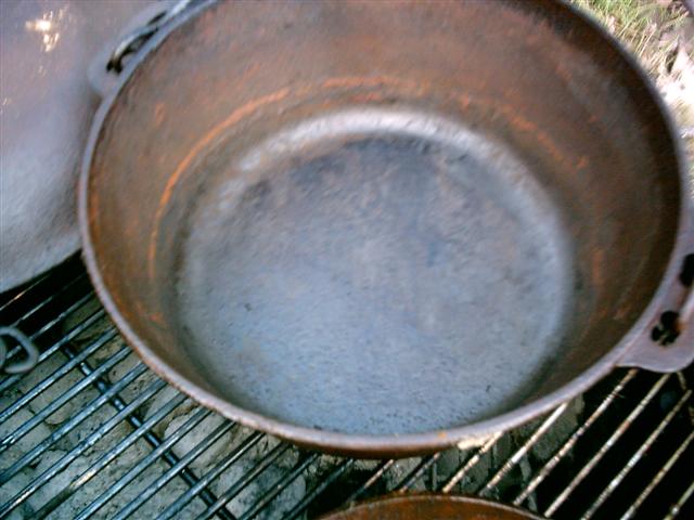

Postby Eunice » Thu Nov 08, 2007 12:55 pm
This is the same dutch oven after just one cleaning/seasoning on the BBQ
