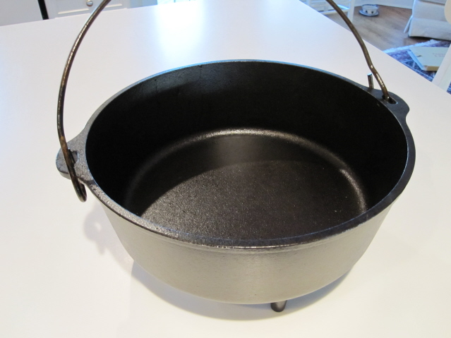

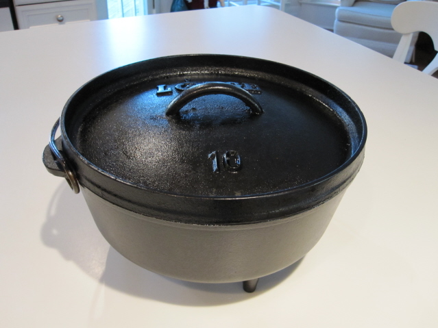

Postby SmilinJack » Sun Dec 27, 2009 9:05 pm
Kevin,
Success!!!
After Seasoning:
With lid:
Thanks!
Jack
SmilinJack
Posts: 99
Images: 32
Joined: Mon Oct 19, 2009 7:50 am
Location: North Carolina
Postby Kevin A » Sun Dec 27, 2009 9:20 pm
Ain't THAT a beautiful thing? :thumbsup: :applause: :applause:
