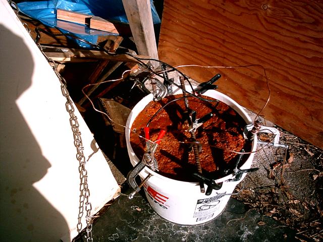

Sorry to be so slow in getting back to this thread. I think the suspension is a fail safe method in case a lot of rust settles to the bottom as it comes off of the piece. It keeps the material from forming a short circuit between the sacrificial rods and the piece you are cleaning. Just as Dean said if you can't use a bolt a clamp of any kind can be used as long as there is a good connection.

Postby Eunice » Thu Nov 22, 2007 11:21 am

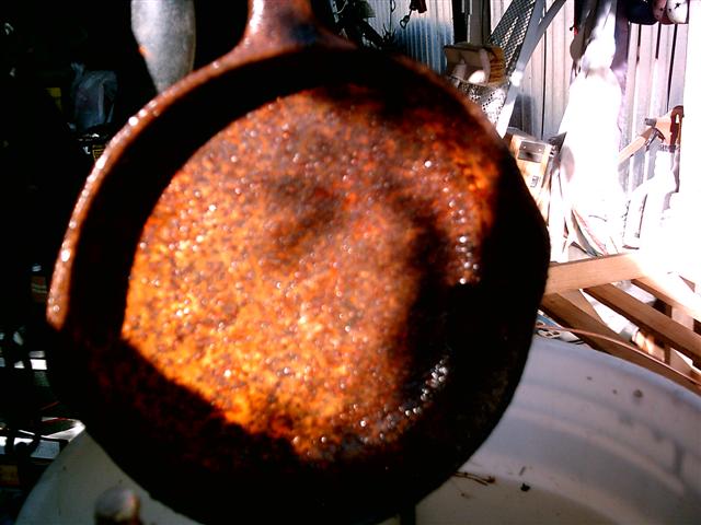

OK here is the first pan going in
coming out

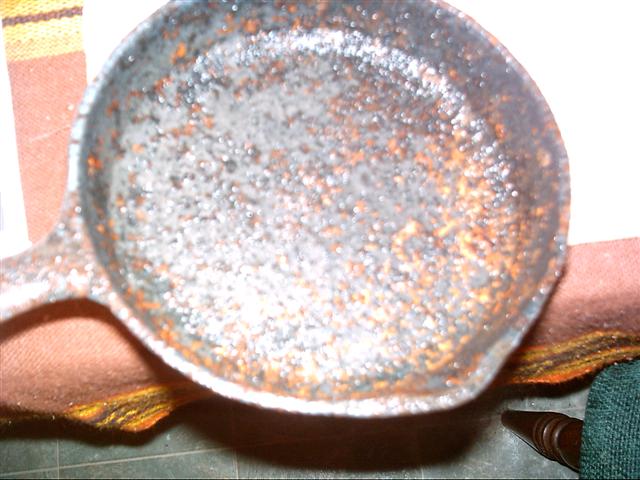

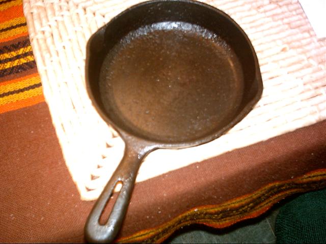

and cleaned
it is pitted but a few seasonings will take care of that. I am impressed with this process and will do it to all the pans. Sure doesnt take the elbow grease that I was doing!

You saw the picture of the first pan. it still needs work.

I will post pictures when I get a pan really clean.

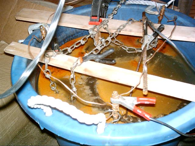

electrolysis
Postby Eunice » Mon Dec 10, 2007 8:21 pm
Ok the small bucket is the spa/pool stuff after several hours and the large bucket is the arm and hammer washing soda after about one hour. This works so much better than trying to bake baking soda to make sodium carbonate.
The large bucket has a 10" DO and lid plus a 10" skillet at the same time

Dave I held out for a long time but this really works! it is amazing to see all the goo that builds up on the rods I have in the bucket. be sure to clean them off everytime you put something new in the bucket.
