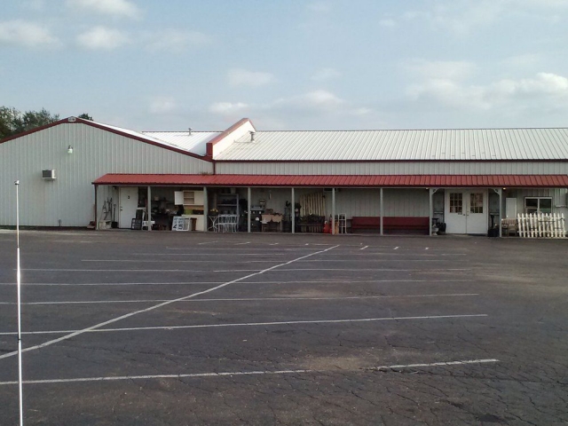

There is a nice antique shop in Plainfield I have picked up a couple of pieces of cast iron there reasonable ! :D
Gilley's on US 40 Image
