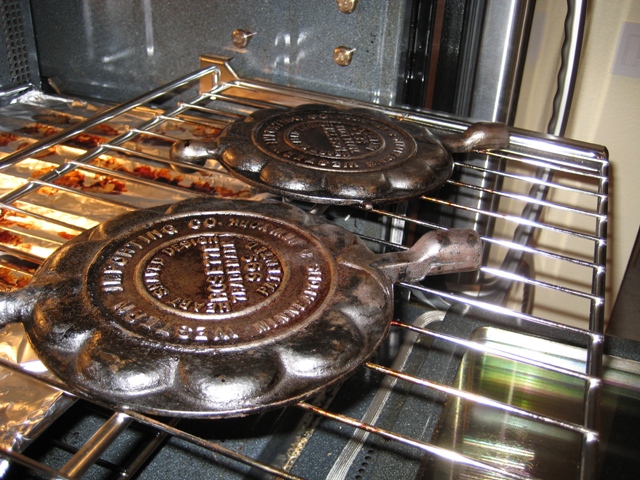

Postby pgwilli » Fri Aug 10, 2007 10:59 pm
Here's where I'm at

Postby halfdome, Danny » Fri Aug 10, 2007 11:07 pm
pgwilli wrote:Here's where I'm at
(remember when we went out carousing Friday nights??)
Paul, are those the heart & star ones? Lookin' good. :thumbsup:
