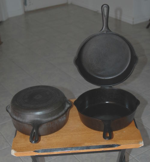

For those of you who have never seen one of the old chicken fryers, here's a photo. The top skillet has a tab that fits in the slot of the bottom skillet. The two form a hinge.
In this photo, the skillet on the left is a Wagner and the one on the right is a Griswold.
In this photo you can see the tab and slot.
If any of you happen across a hammered skillet with the tab on it, you may want to give Doug a shout. I'm sure he would appreciate it! :thumbsup:
