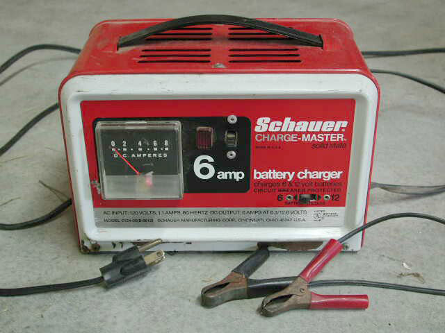

I took my buckey, fileed with water and washing soda, clamped a steel rod on the side, clamped another steel rod on the rusty pan and attatched my 10 amp battery carger to the rods... POS on side NEG on pan. Turned it on.... nothing happened. Got out my meter... no power on leads. Thought for a while.. why doesn't this work? Got my battery, and connected the leads to the battery, and the charger worked. Connected the leads to the rods... it didn't work. So now I have my charger connected to the battery, and my battery connected to the rods, and I got a little bit of reaction going on. But only on the side closest to the POS rod. What have I done wrong? I shouln't need the battery in between.... do I have the wrong type charger?
What is the right type of charger do I need????

My Wal-mart (cheap) automatic battery charger won't start working without a battery attached to it. My neighbor brought over a battery to charge that had been drained to 0 volts, and the charger wouldn't start up. I thought something was wrong with the charger and got the jumper cables out to charge his battery from my truck. After a quick jump start the charger, still attached to the battery came on and charged OK.
Steve

Maybe some chargers have a built in saftey feature....if they don't sense any resistance or something, they don't start charging.

I have found that the newer (digital) type chargers do not work as well or at all when I use this method for
cleaning cast iron. I have had them do anything from throw and error code when hooked up to turning off and on
every 2 min, but connect them to a battery they work just fine. I hav found the older (non digital) type work better.
I have done about a dozen pieces so far and think this is one of the best ways to clean your CI

I bought a new "electronic" battery charger that uses hi frequency stuff to desuphate batteries, can float them, and all sorts of cool stuff the old fashioned kind can't do.
BUT, when you connect it to a "dead" battery the indicator lights tell you you have a reversed connection and nothing happens. After discussing it with the factory they realized what was happening and that the charger won't start on a battery less than 5 volts (for protection reasons) and when connected to a battery of less than 5 volts gives the false reverse connection light combination.

I knew I kept my 30 year old Dayton charger for a reason, it'll even charge 6 volt batteries.
