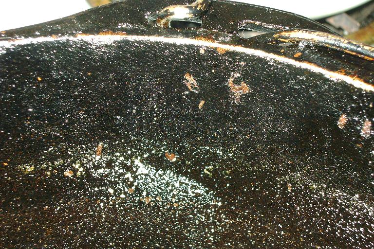

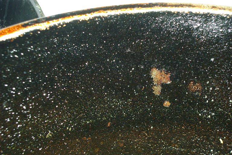

my point is....today i fried some fries and some shrimp(first time ive ever used it on my propane burner outside, always been on stove)....while eating my shrimp, i noticed some little black flakes (smaller than a pea, bigger than grains of pepper) on my shrimp.....went out, drained the grease, inspected the pot...sure enough, there are little spots where stuff just kind of flaked off the inside...
what do i do with it now?? just not worry about the flakes??

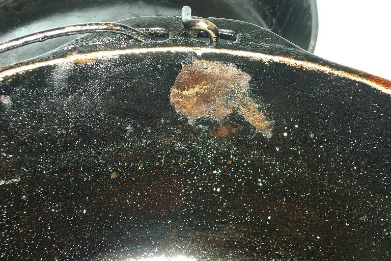

hmmm...i was uploading some pics...figured i might not have made sense...
so, just scrape the stuff out, and then i got a start all over?? that sucks....
this is after i kinda picked at it with my thumb nail...
thanks..

so...
Postby laoutdoorsman » Sat Oct 03, 2009 5:15 pm
so, is that just a buildup that needs to be removed from time to time??normal??something i had done wrong??

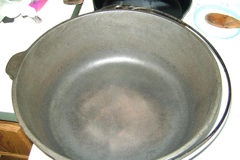

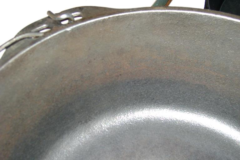

Postby laoutdoorsman » Sat Oct 03, 2009 7:16 pm
ok..i got it hot on my burner outside, and the gunk just peeled right off...i buffed it completely out with a wire cup brush on a grinder....now im gonna season again...
i did find like a little pinhole in the side of the pot...doesnt go all the way thru, maybe about a 1/32-1/16 deep...i guess thats normal/ok??
would it be worth the trouble to try fill that hole in and grind it back smooth?? or just leave it...now would pretty much be the time to do it..im equipped to weld cast...any suggestions??
i sure wish i had done this before...man, all that bacon, and hamburgers, for nothing....lol

Postby starleen2 » Sat Oct 03, 2009 7:39 pm
If ya' want to fill the hole - now would be the time to do it - I wouldn' take the time, that's just me (if it aint craked or leakin', leave it alone!) Now season that baby and get after it!
