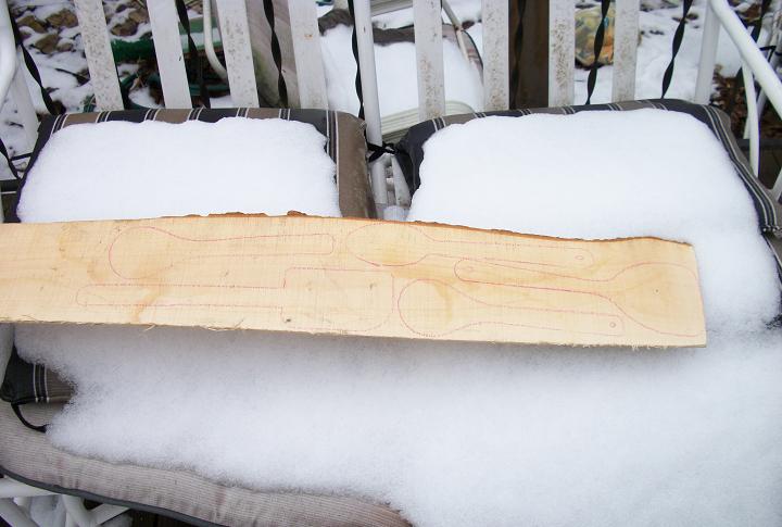

I really like your utensils Bob....what type of wood did you use and did you seal them with anything like a mineral oil? I will whittle one while out camping, and have some done in aspen, 1 piece is 14 years old now and I use it all the time. Making up a couple of blanks might be a fun thing to finish off while camping. Thanks for posting the pics....Doug

I have a co worker that has a wood mizer portable ban saw and he slabs off test slivers to be sure all the adjustments are within tolerances. Well he brought me in a test sample about 3/16" thick. It sat in my office for 2-3 months with minimal twisting or cupping so I decided to take it home for something??
Well I was working on my satellite dish dutch oven stand so why not.....
I simply traced the plastic utensils in the pic and took the blank outside and jig sawed them out. All of them took less than 10 minutes.
The wood was from a hard maple and after sawing I sanded them a bit but not to furniture quality. I then filled a cake pan with cooking oil and let them soak 24 hours. Took them out washed them with soap and water and sprayed them with a light coating of pam cooking spray.
My favorite is the angle nosed spatuala.
