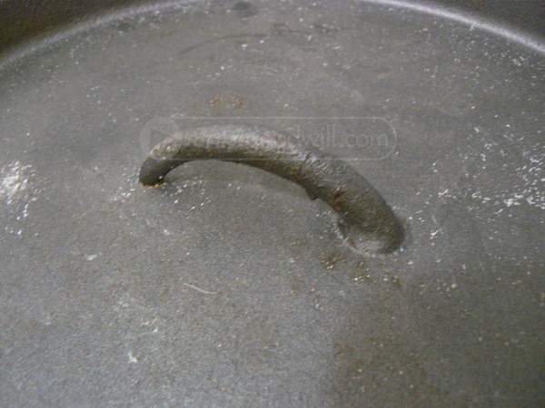

Postby bobhenry » Fri Aug 01, 2014 7:16 am
Speaking of handles.......
Is this type of handle brand specific to the older lodge pieces.
It reminds me of a pumpkin stem. It looks to have sprouted out one side and has re-rooted in the other.
Re: Handles
Postby SmokeyBob » Fri Aug 01, 2014 8:34 am
bobhenry wrote:Speaking of handles.......
I've noticed that myself. Could be an interesting story. Why did they make it that way.

Postby Corwin C » Sat Aug 02, 2014 2:40 pm
Just a guess, but the shape suggests that they are using a sand casting process and the blank that the sand is molded around has a tapered and likely flexible piece that will pull free of the sand without destroying the handle shape. When the iron is poured in, it becomes a solid part of the lid and then the sand is broken away to be recycled into another mold. It would be an easy way to have one less part in the mold.

Postby bobhenry » Mon Aug 04, 2014 7:48 am
But is this design brand specific ?????
Re: Handles
Postby SmokeyBob » Mon Aug 04, 2014 11:30 am
bobhenry wrote:But is this design brand specific ?????
I have a 10" by Cabelas and the lid handle is shaped the same, but mine is smoother. The handle opening on mine is so small I have to use a lid lifter or grab the lid by the sides. When the DO is cold it would be nice, for me, to have a larger lid handle. But I guess, especially with the heaver lids, using a lid lifter or picking it up by the sides would work better.

Postby KCStudly » Mon Aug 04, 2014 1:30 pm
My guess is that it is a stress relief issue. If the handle grows and shrinks at a different rate due to it being out in the air, by being fixed at both ends it could develop enough stress to crack, so by alleviating that stress by allowing it to free float, it can grow and shrink at its own pace and not develop any stress.
Break the joint because it would break itself anyway.
