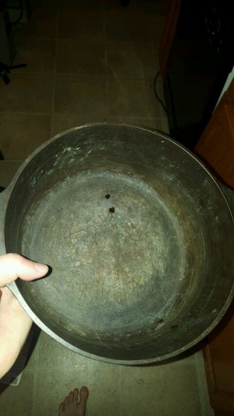

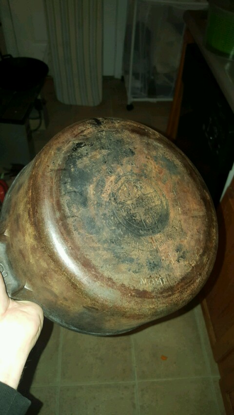

Here's the pictures of a really nice Griswold block logo dutch oven before I restored it.

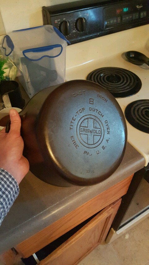

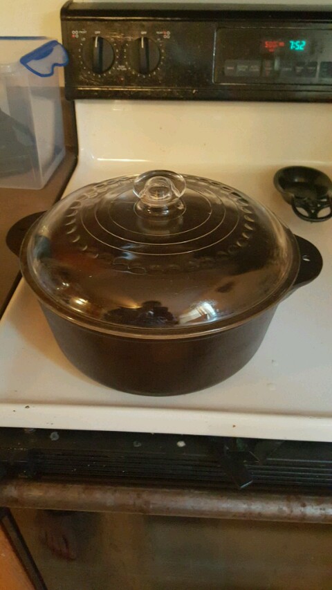

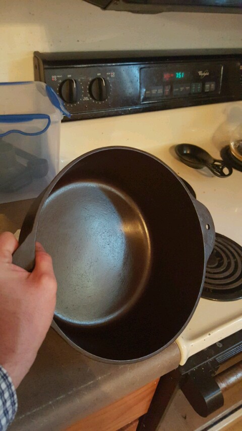

Here's the after photos
