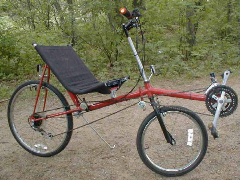

Here's the short wheelbase recumbent I built a year and a half ago: Image
the build website is here
When I finish the trailer, I'm thinking about starting another.

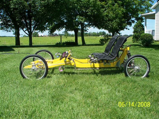

I built a four wheeled sociable afew years ago
it has independant suspension and gearing, disc brakes. The frame is made of plywood covered in west systems epoxie. There is some more pictures in my album.

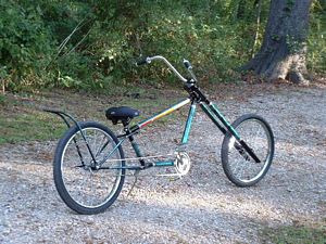

Pictures are long gone in a house fire but at about 13 I decided I wanted an upside down bicycle.
You take a standard 26" midweight bicycle and remove rear tire and pedal crank and reinstall backwards so when you flip the bike upside down it will pedal correctly. Remove the front fork and reinstall it upside down. You will need to weld in a handlebar extention and a long seat post. I struggled with this part of the project until our neighbor Mr. Hudson heard about my delima. He owned a machine shop and he loaded me and the bike up and in 20 minutes I had the extensions installed and was good to go. I road my upsie down bike thouands of miles in the next couple of years. Mr Hudson is no longer with us but I would still like to thank him for reaching down and helping the "neighbor kid"

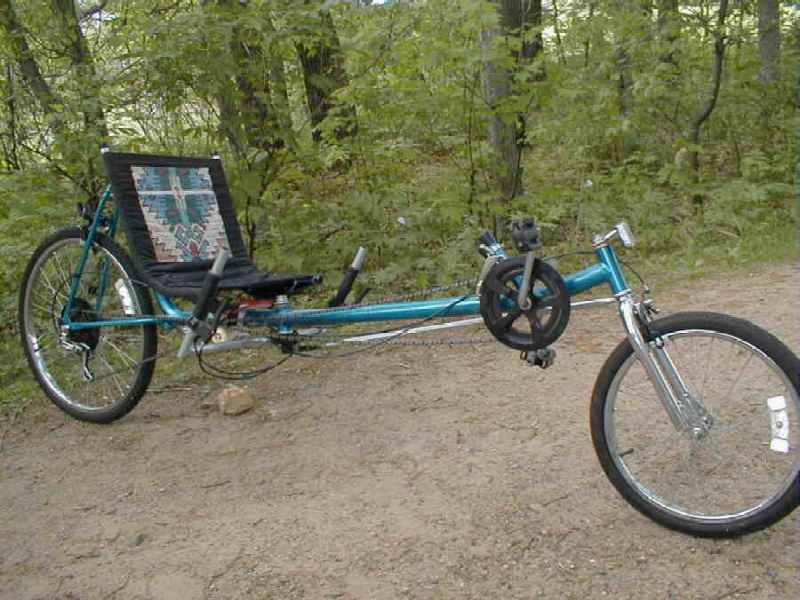

I have posted this before...but I got interested in building recumbents about 10 years ago.
This is the first recumbent I made. Turned out really nice...I still ride it...very easy on the neck and wrists.
The plans came from http://www.bentechbikes.com/. I modified the original plans to use a standard bike rear wheel stays (triangle).
I made another one for my daughter and then this long wheelbase model.
