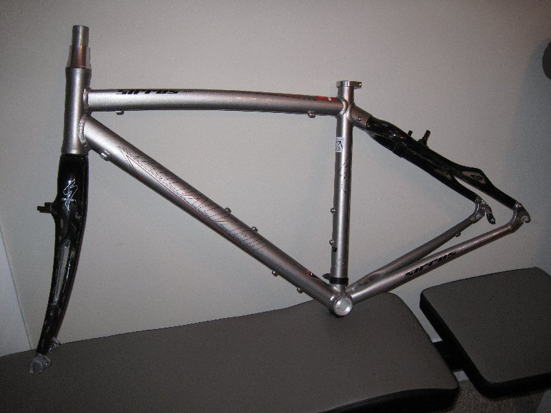

I am building up a Specialized Sirrus frame. I am trying to choose one of the Mavic wheels... which one would you choose and why?
http://www.mavic.com/road/products/rims_range.2.aspx
I am building it up like a cross bike, but with flat bars. As such, it'll probably have tires like the Continental Travel Contact (28c) or the Vittoria Cross XG Pro (32c).
Any suggestions?
