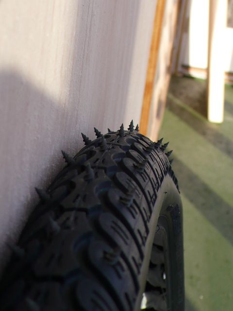

I used 120, 1/2" self-tapping sheet metal sqrews.
Needed something for this supposed 6" blizzard ( in Ohio ) .
I lined them with and old road tire with the beads cut off.
Totaly worthless on paved, feels like, riding on 2 flat tires ...

I used 120, 1/2" self-tapping sheet metal sqrews.on the front tire and 160 on the rear. It doesnt look good, but works awesome.
I lined them with and old road tire with the beads cut off.![]()

First and foremost, I am not trying to start a fight. I'm just doing some personal research on the term "self tapping sheet metal screw". Since there is in fact no such thing as a self tapping sheet metal screw I am kind of currious how this term ever got started in the first place. It seems to be a fairly accepted term in most parts of the country. The screws you show in your picture are in fact self drilling sheet metal screws. do you have any insight as to how or why the term self tapping is substituted for self drilling? Self tapping is a term used for machine screws that cut their own threads as opposed to a sheet metal screw that drills it's own hole.
Thanks in advance for any insight you might be able to offer.
