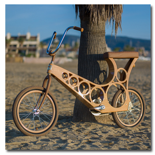

I was thinking a little more traditional. Maybe something like this.
How would one even build something like this?

Postby Greg M » Thu May 04, 2017 9:27 pm
mikeschn wrote:I was thinking a little more traditional. Maybe something like this.
You'd need a pretty big steam box, and a whole lotta clamps...

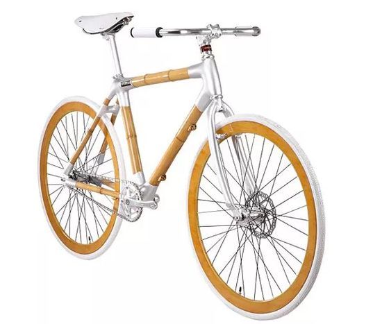

Postby Awesomejim » Sat Feb 17, 2018 5:55 pm
have bot built ine but saw a bamboo bike at a ride in Connecticut. The builder was a craftsman, it looked just like a carbon road bike, you barely would have known, beautuful.

Postby tony.latham » Sat Feb 17, 2018 9:48 pm
I would think that was done by steam bend multiple laminations over a form––one lamination at a time. I've steam-bent canoe stems that way but this would be way above my pay grade.

I have never built one but would love to. My methods of creation would depend on the look you are going for. Admittedly, with a veneer you maybe could change it all after you do something else for structural.
The easiest method would to do a plywood bike using two laminated 3/4” Baltic birch pieces and cut out the frame components and route and sand them until you achieve the curvatures you want. Pretty simple really, and quite strong. I made Olympic Rings this way and they were super strong.
The next method for strength would be custom laminates by slicing thin pieces and glueing them. If you stick to mostly broad angles and thin (<1/8”) you can get away without steaming. But steam boxes aren’t complicated so could go that route as well.
Another option might be finding quality stock and turning the tubes on the lathe and then using plywood or laminated just for the joints and tail forks.
I would recommend fiberglassing the top no matter what, but definitely if you go with solid wood. Laminate structures are so strong it’d just be for maintaining the finish...
But generally you can make anything out of wood similar to how you would do it out of metal. The seat post junction comes to mind. Just make a laminated block of maple or other high quality wood and mill it to shape and cut the appropriate tube holes by drilling. (I would do the holes first and Mill after, just to be clear.)
