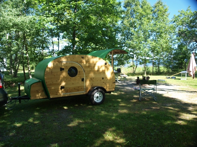

You can see the tongue box on TD#1 in this photo. I haven't loved this thing since installing it. Leaks, which causes some mold and it is poorly designed for storage space. I mostly keep unused crap in there with the exception of a small folding table and a couple wood platforms I made to put outside my cabin doors to keep my feet out of the mud.
I removed the box and have been thinking of a new design that is less stylish box than utility box. I'm picturing a rectangular 48" wide 24" long and about 12" tall squarish thing made of 3/4" plywood sealed with PMF just like the TD. On top of the box will sit fork mounts and a "cup" to cradle the rear wheels. The TD is 61" wide. Both my mt bike and road bike will easily fit on the 48" box. Here's the tricky part. The tongue box will have two watertight drawers opening to the curb and roadside. One will fit my table and platforms (26"x20"x4" stacked) with room to spare and the other side will hold small tools, chocks and the like.
I know I can fit two bikes on there as I typically remove pedals and turn handlebars to discourage theft. I think the drawers will have a homemade hatch that opens to access each drawer. I searched tnttt for something along these lines. While I found many creative ways to add bikes I didn't find anything with drawers which should give me good access to my tools and other items that I use regularly.
I'm open to any suggestions or warnings...
Tim

Thanks for the reply AH! Yeah, I gave that some thought. The boring details... Before remodeling my tongue weight loaded is around 160# (loaded trailer is 1350#). I'm going to save about 10-15# with the new box and loosing some of the crap I won't be putting back into the box. The box will be just big enough to hold my platforms and small folding table and a wheel chock and wrench so I won't be tempted to fill it up again. One bike, sans front wheel, is 27# with the fork mount and rear wheel pocket (rack is just a simple fork mount bolted to the plywood box and a very small rear wheel pocket with a nylon strap). I'm estimating weight with one bike will be under 175#. At 160# the trailer pulled well and caused little squatting of my TV. I can futz with that tongue weight a bit by packing my cabin smartly.
Update... after more thought about Andrew's post I have decided that lightening up the box will be a good thing. I don't think I am way over capacity, but, it was getting close to over the line. I have redesigned the interior of the box and eliminated at least the long drawer. That side will now just be a cubby for the table and platforms. No need for a drawer and it's heavy ball bearing slides and case. I'll still do a drawer on the other side for small tools. Haven't come up with a final design for the hatch covers. I think they will just be like caps with weatherstripping and they'll be held on with some sort of draw catch. Just finishing up the PMF with painting yet to go. Painting is the easy part. Then I can determine the size of the hatch covers.

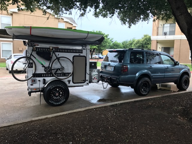

Postby Akuma129 » Fri Sep 01, 2017 9:42 pm
Here is what I did, bought e track rail and e track trimer (weed waker ) attachments bike snaps right in and is secured./Users/JJ/Desktop/Travel Trailer Project/IMG_2351.JPG
