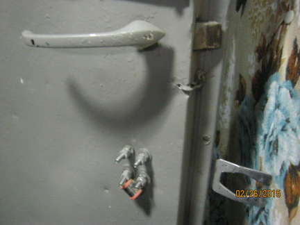

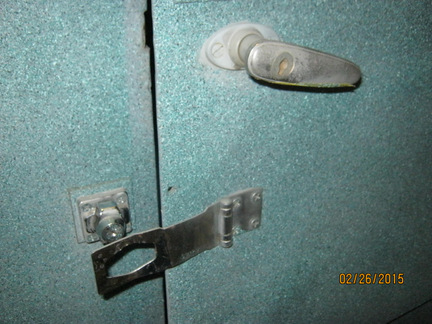

First photo - outside - 2nd photo = inside
Since I haven't gone out and camped alone yet.....it's interesting reading all of your posts. I have a dog and don't ask about firearm :twisted: My problem is what kind of lock on the "bedroom door" of my teardrop? The lock that's on it, can only be locked on the outside.!! Scary.!!! I'm thinking I'll take that off and put a deadbolt on the inside. How do you ladies do that? Do you trust the latch that's existing? Should I plan on getting a newer door?

A sliding bolt type on the inside for peace of mind when inside. Also that outside hasp should have a way to disable it, a way to lock it in the open and unlocked position so there is no danger from a jerk locking you inside.

That hasp lock is on wrong anyway. The screws are supposed to be covered by the hasp when closed. It needs to be folded under the hasp.
