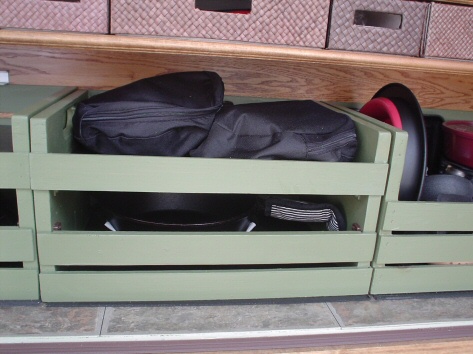

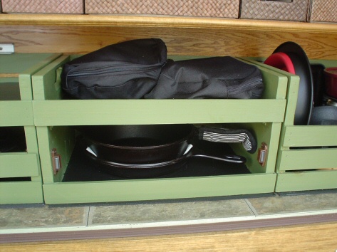

I'm using tool tray liners from HF to keep crates in place. They are much thicker that regular shelf liner and since it holds the cast iron stuff it has worked super.
I took some slats off of the three bottom crates and on two of them have have a removeable slat. Here's what the crate looks like when I travel.
When I set up I remove a slat and have easy access.

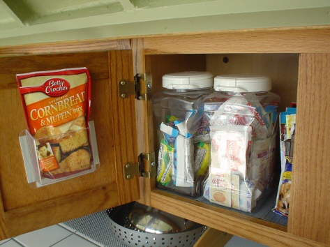

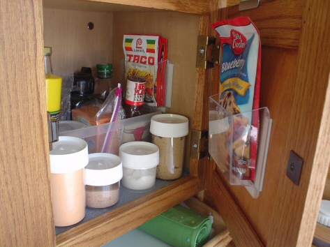

My Home Depot cabinets are really nice and on one side I added room with these cool pocket holders for the packets of ingredients you might have in camp.............or at least things I use when the real cook of the family, Rose, is back home. I found these at organize.com.
These larger containers hold a lot of smaller things and easy to grab stuff...especially when I'm running around in the morning getting ready for a day of kayaking fun and want to stuff my lunch bag.

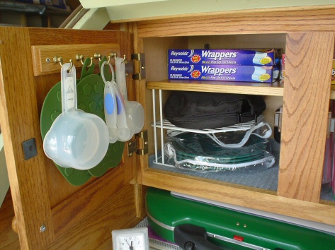

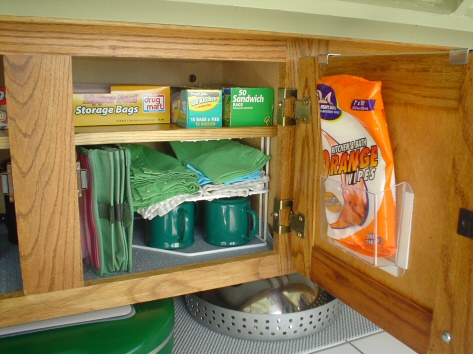

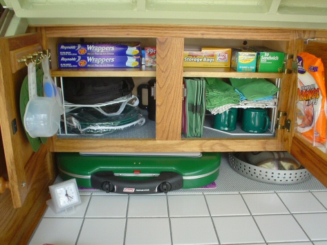

The other cabinet has added space because I used corner shelving and then added an extra top shelf accross by using some leftover birch plywood and a nice piece of trim.
The corner organizers let me add more to the cabinet.
Plus an old key holder allowed me to hang some measurement utensils and freed up some drawer space.

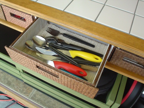

These are those drawers I found at Tuesday Morning. Here's my silverware drawer.

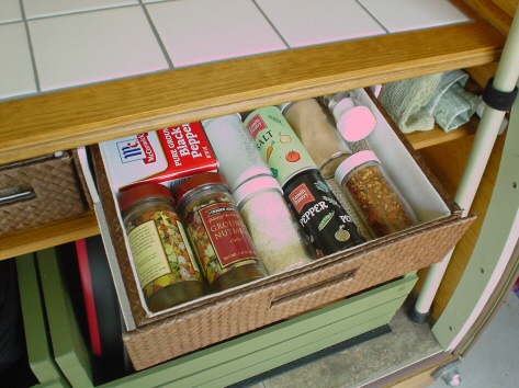

Rose's spice drawer.

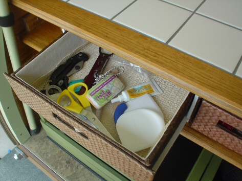

And of course doesn't every kitchen have a junk drawer?

Barb, I am also REALLY impressed. The 'removable slat' on the crate is a brilliant idea! I saw some similar crate style storage boxes at a craft store, but didn't want to keep sliding them across the floor under my bunk/counch. With the slat, I could just reach in. Way to think it through!

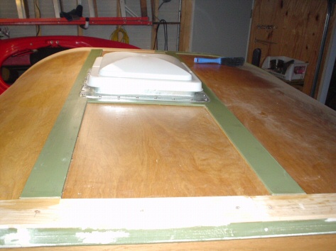

For sure I am intereted in your results too with this product. I am going to fix a design flaw on my td. It hasn't caused any problems for all the times I traveled while raining or while it sat in the rain uncovered in camp. During the build I realized how nice the birch looked so I ditched the idea of a painted roof in favor of a woody look. But that meant I needed a way to hide the screws everywhere and that led me to my trim work that I painted green.
Here's my design flaw.
The trim painting wasn't completed at the time of this picture. I used epoxy with filler for all the small gaps to tie all the trim together but it was tough to sand. The space on both sides of the vent are now recessed. I'm planning on cutting a piece to drop into the spaces on both sides of the vent. This will have the area around the vent even and the plywood and trim are both 1/4" so I'd like to use this product to fill in the gap once dropped in. I've been in really bad rain while driving but I think it's best to make that section on the roof at least flat so I'll add this to my "winter to do list"!
Closer look at flaw. This was before the vent was permenently installed and shows the 1/4" recess a little better.

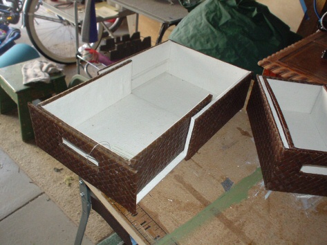

Here's a few close ups of the drawer. I bought them from Tuesday Morning but if they are no longer available here's the website off the tag:
www.neatnix.com and their # 1-800-683-6328.

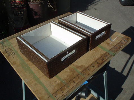

I used the 4" wide and 9" wide for my td. Here's a pic of a 6" and 4" side by side.

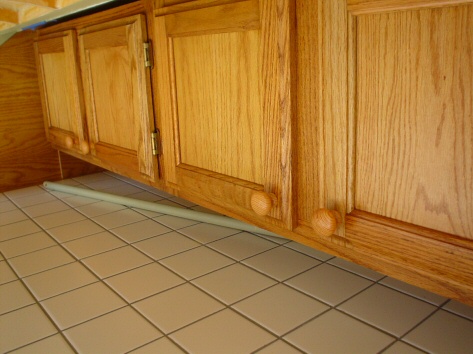

Here's the one drawer partly opened. I added a shelf under the counter and put one screw in the base. It's working great.
These draws were a complete after thought. Here's a pic of my galley when I was almost finished.
I added the shelf and left enough room at both ends that I use to roll up and store my kitchen towels while towing.

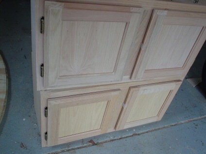

The cabinets were at HD and just needed to stain them. They are the smaller size that you would typically install above your kitchen sink. With 30" wide two of them gave me my perfect fit for the 5' wide td!
I used the same stain as the wall and finished them with Clear Shield Satin. Then beside being tied into the galley wall they also sit on a 1/2" "box" on three sides. It was the same pattern and left over from the walls so it matched perfect and was eventually hidden and finished off with quarter round.

Barb I have the same design flaw. Makes a very shallow lake. I didn't want the water to force it's self under the trim so I epoxied a dam on all sides of the trim on top. It has been standing in a very hard rain and while it didn't leak it did make a lake. I am thinking of fiberglassing, or something next spring.
