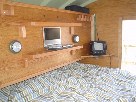

Postby b.bodemer » Wed Dec 05, 2007 9:58 am
Mandy,
I opted for kitchen cabinets in the galley so in the cabin I used the top of those cabinets for a shelf. At least my pic shows you can still have a lot of space to hang/store things even without cabinets in the cabin so anything you might add would be a bonus.
Here's my simple cabin set up. A before and after look.
I even used some left over oak from the side walls to create corner shelves. The shelves rest on some framing and even pop out(I used magnets for kitchen cabinet doors).
I found all the shelves and hooks at Ikea in the bathroom section there..........great price and it's maple too. Gave a nice clean look to the cabin wall. That's also a black nylon shoe box from Ikea......It holds lots of little things too so I have one on each side.
Have fun planning.......................
