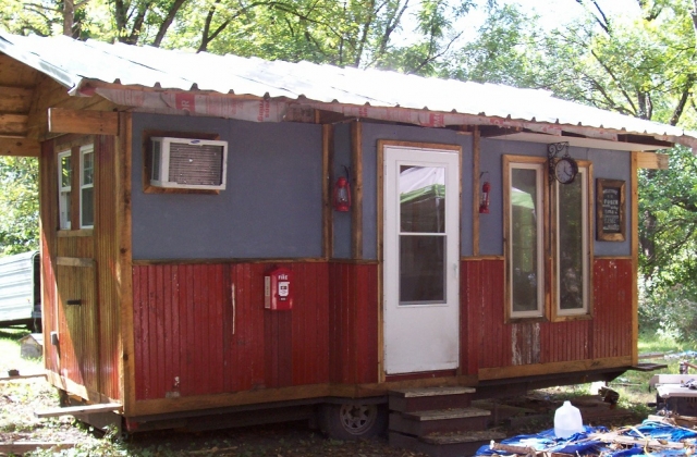

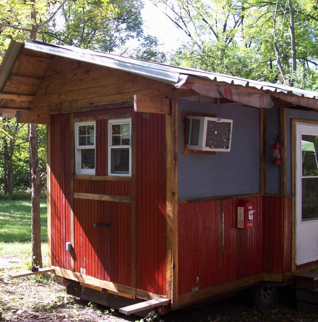

Postby Nansplace » Tue Sep 18, 2018 7:22 am
The depot looks great! I especially love the clock, it makes it look more authentic. Great job!

Postby bobhenry » Tue Sep 18, 2018 7:33 am
I am hoping the grey stucco finish will add even more to the look. Looks like rain next weekend , if so it will be an inside drywall week end. I really hope to get up on the roof and finish it and get the soffit and facia installed. I have the solar panels unpacked and ready to install as soon as the roof is fully tightened down. We have it sort of "tacked" in place at the moment. October 1st is roaring up on us and that is the one year anniversary of the start of this project. I was trying to be finished with the "construction" faze of the build by then, looks like we may dribble over a few weekends. I was still very happy with the giant leap of progress we made this weekend.

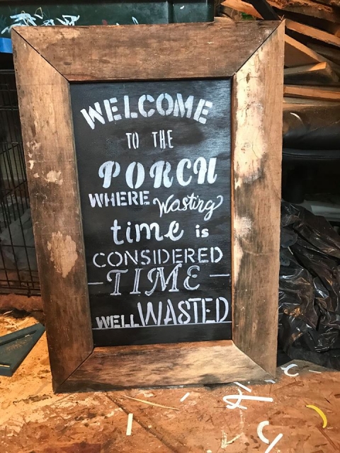

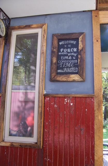

Postby bobhenry » Thu Sep 20, 2018 5:56 am
Found a sign maker and asked if she would do a couple custom pieces for me. This is the first one for the "Platform" (patio deck)

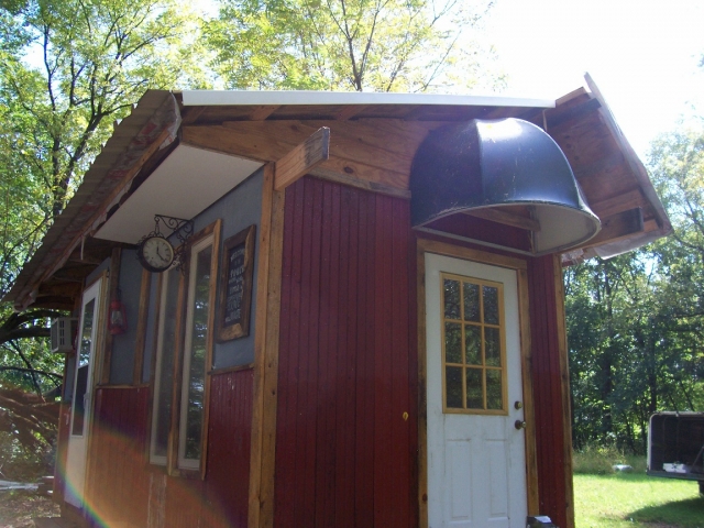

Postby bobhenry » Sun Sep 23, 2018 6:28 am
Well I supervised a couple of great guys while they installed a front porch roof for the landlady. I stoled some time during their work to go up the hill to the depot and install door trim stops and threshold. Finally have the locks in and can secure the saws and tools. I feel better now. I tried about 4 profiles for the stops before I found one I liked. (Yes I cut my own out of scrap wood ) I was also able to get my $45.00 Craigslist find a Larson storm door installed.

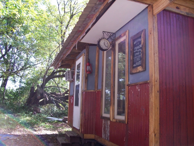

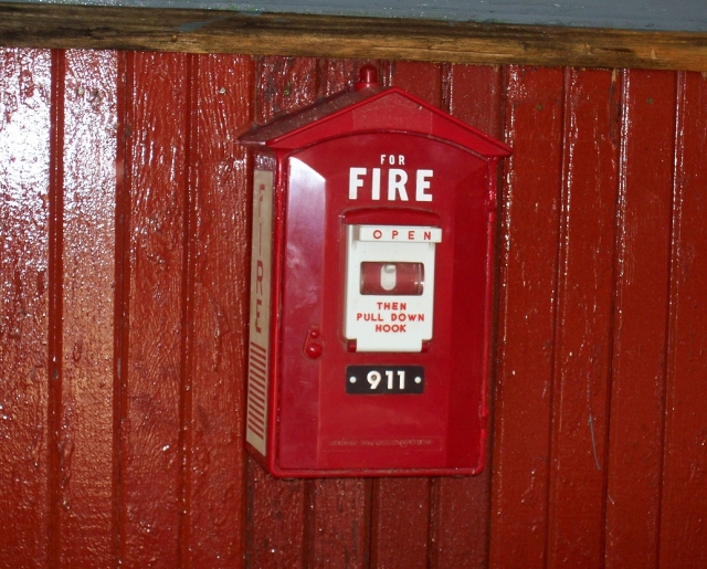

Postby bobhenry » Tue Oct 02, 2018 6:06 am
It's prettier now.....Image
Left the patina of the 1909 boxcar tongue and grove car siding and just poly semi gloss over it to protect it ! The experiment with the polar seal mixed with exterior latex paint and thickened with drywall compound for the stucco look went well but did not have the body I had hoped.
Loved my custom made sign
and my free yard sale call box

Postby swoody126 » Tue Oct 02, 2018 7:15 am
BH, have dropt in on this thread several times just to see where you were going
NOW it'z obvious you went down a pretty cool trail
just to let you know...
I HAVE STOLEN MANY OF YOUR IDEAS
:applause:
sw

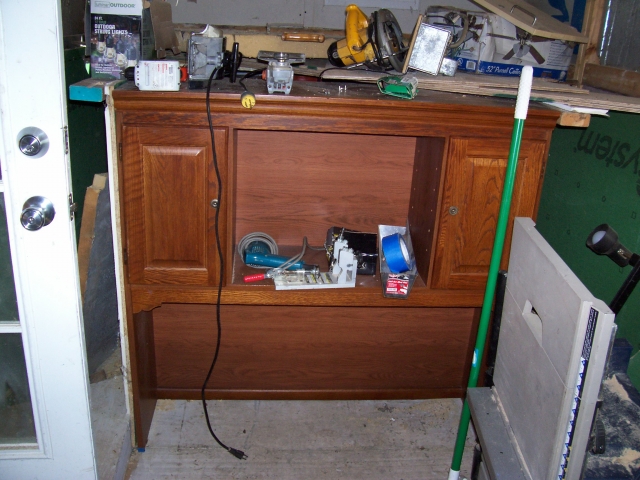

Postby bobhenry » Mon Oct 15, 2018 11:20 am
Cost info updated above :
Well almost 8 hours on the roofing it is drip drop tight and weather permitting it will get a coat or two of polar seal next weekend. While I acted as ground man and passed up tools and materials as needed , I used my in between moments to install nailers and hang drywall inside. Hit yet another yard sale and snagged a very nice hardwood cherry desk topper it measured 48 x 48 x 12 deep.
The dead space in front of the water tank was 14'' deep and 48 wide by 46 3/4 tall so with a minor trim at the base of 1 1/8' it fit hammer tight. It gives me two very nice storage cabinets and an area in the center that just may hold yet another zero clearance ventless propane heater. There was a companion single cabinet 24 wide by 4' tall that I am yet to decide what to do with. Both cabinets for $20.00 total. I am six pieces of soffit and 4 facia boards from being fully insulated and ready for zero weather when it comes.
