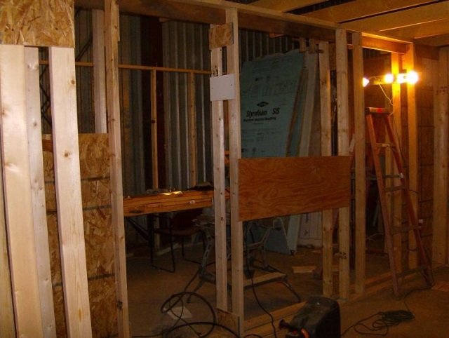

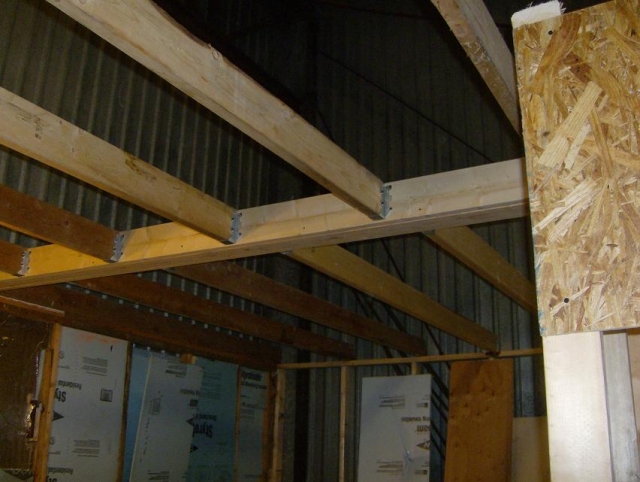

Here is the neich wall between the l/r and b/r the little plywood gussets are temporary to keep the legs seperated exactly to the width I wanted they will be removed. The center neich where the big sheet of plywood is will serve the livingroom, The neich where the ladder is located will serve the bedroom as will the one on the opposite end.

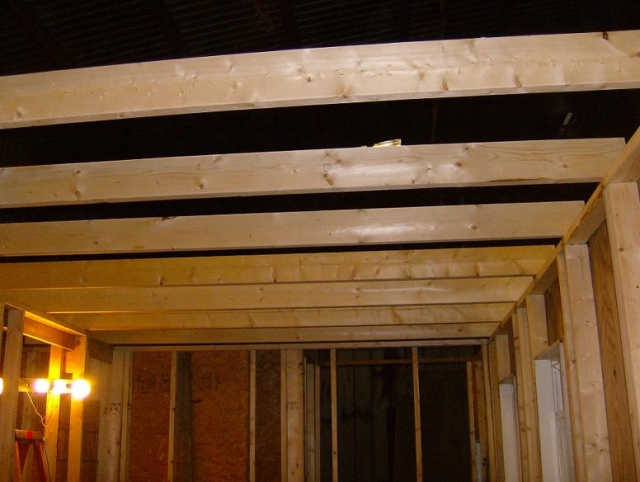

Here are the livingroom ceiling joists in place !
and the kitchen ceiling joists in place.

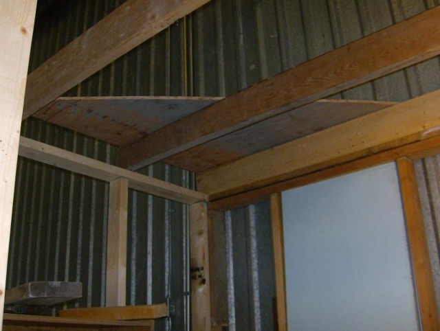

As the waste strips are 18" wide by 8' long I will install the decking on top diagonally and reverse the second ply. Here is the very first piece going in.

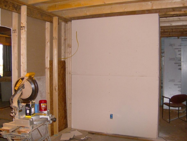

Well a couple hours of work last night and the neich walls are all completed and check out as plumb and square and semetrically balanced left and right. Kind like a guy planned it huh?

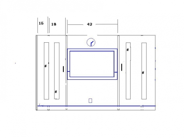

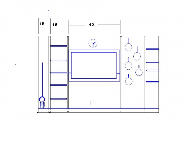

Well I took all the little scabbed on plywood gussets in the picture above and they are gone now that all the studs are securely fastened into their upper wall plates. Here is the plan for the kitchen room hide away wall.
left to right: a broom closet, pantry for canned and boxed goodies, a let down table disguised as a bulletin and white board with what-not storage behind. next hang up skillets ect. and finally a spice pantry. There will be doors over the right and left sides I may dress them up with 8" wide by 7 foot mirrors I have had forever.
That's sure a lot of storage in 7 1/2 square feet of floor space :thumbsup:
Re: HOUSE IN A HOUSE
Postby S. Heisley » Tue Oct 22, 2013 1:04 pm
Perhaps you could make those doors so that they could be folded down into benches on either side of the table? (You'[d need to switch the location of the spice rack and the pots and pans.) If the top part of those doors were to be hinged in a couple places, cross-ways, they could become the bench leg on one side of the bench (locked in position, when used either as part of the door or as the bench leg). They could still be hinged on the sides so you could open them side-ways; but, use separate side hinges at top and bottom so you could pull the door-type hinge pin from the top hinge to make it possible for that part to fold down. ...Just an idea for thought.... :thinking:

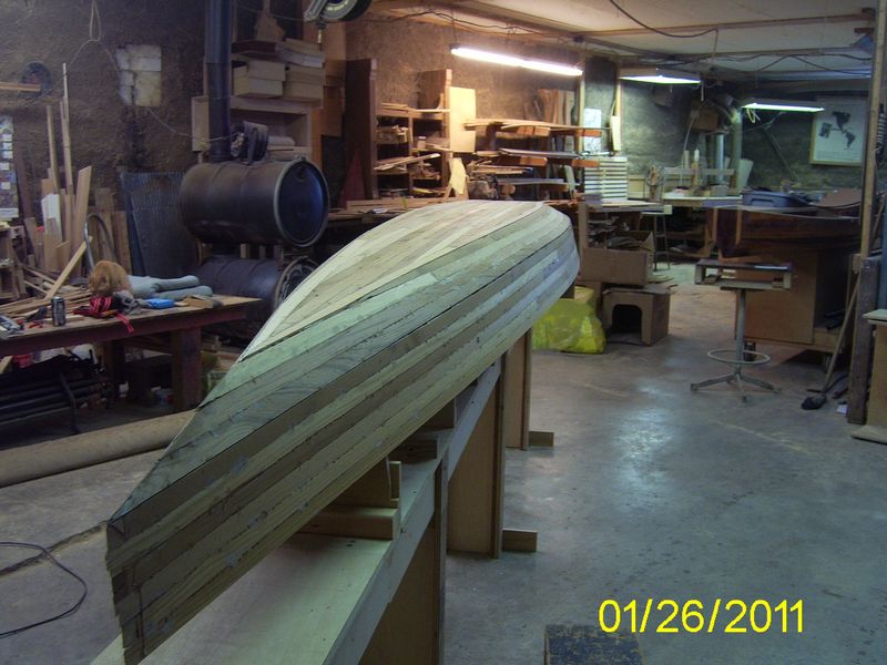

I live in the county outside big city limits...And some people have built big polllbarns and finish off part of them for living quarters.....My room addition I built 10 yrs. ago is a 30X60 pollbarn type construction insulated with 10'' thick Styrofoam coated with stucco over chicken wire and , metal siding a roof....
My old 30 X 60 pollbarn- wood shop is insulated with 300 straw bales stacked along the inside walls and 4'' thick 4'x8' sheets of Styrofoam suspended below the trusses....It never freezes in there even if I don't get the wood stove (the only heat source) going through the winter...

Postby Woodbutcher » Tue Oct 22, 2013 6:07 pm
Love the stove. We made one of those years ago and burnt our wood scraps. I think it was called a Sotz (SP) heater. That thing worked great. Wish I had a shop as big as yours.

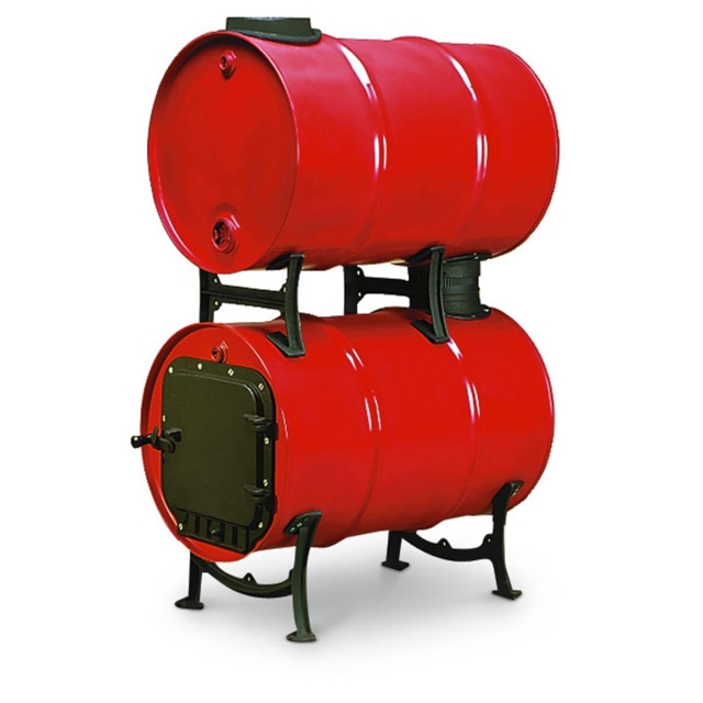

Len Sotz was a garage inventor from Ohio. He and later his son Steve brought us other such things as The Monster Maul and the newspaper log roller and a cant hook type lifter for firewood cutting. I suspect that when his patent ran out on the stove he was overrun by larger companys and couldn't compete with the likes of the United States Stove Company And Vogelzang Inc. Both of these companys offer a very similar barrel stove kit to this day.
Todays offering from U.S.S.C.

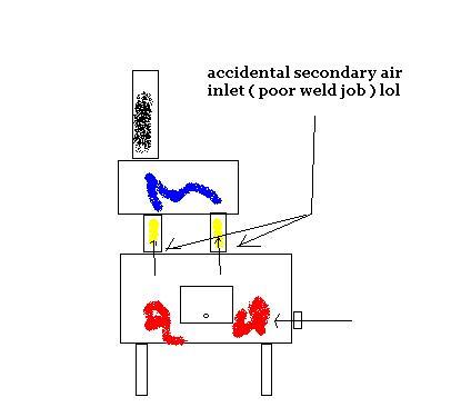

Right after my first divorce I went and lived with a buddy in a big old rambling farm house. We where both scratching for a living and heating that monster was expensive. Luckily I was working in Industrial maintainance and had assess to all kinds of plumbing junk and welders and power hacksaws and loads and loads of other toys so I made " Miss Piggy".
I dragged in a 15 ?? and a 20?? gallon water heater and added 2" pipe feet and a 2 1/2 coupling for her nose ( dampered intake air ) and in her back inserted two 4" pipes for heat tubes to the second stage combustion chamber then out the stack. This thing was truely remarkable 2 minutes after ligthing the fire the top tank was [color=#4040FF]hot hot hot
and the fire tank was still hugable. The off gasses were being driven off in the fire chamber and thanks to some poor welds, a few intake leaks at the 4" tubes added oxygen where shown and the gasses were now yellow and blue as your gas stove flame. With a stack damper and a nose intake damper the stove was very controlable and could be shut down almost at will. So in short don't dismiss a secondary air intake in the stack gasses this will make a really clean burning and very effecient heat stove.[/color]

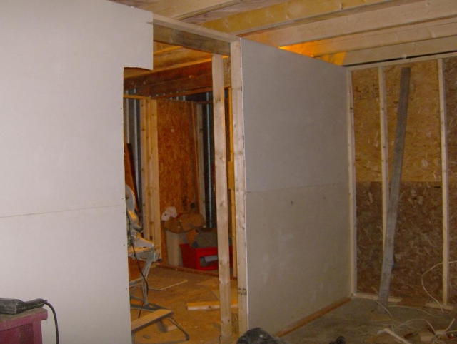

I have a roof well at least 3/4 on and bird poo proof
You are in the doorway looking into the living room the missing section is the livingroom neich which will be shelved
Here you are in the bedroom looking at the back side of the kitchen neich wall.

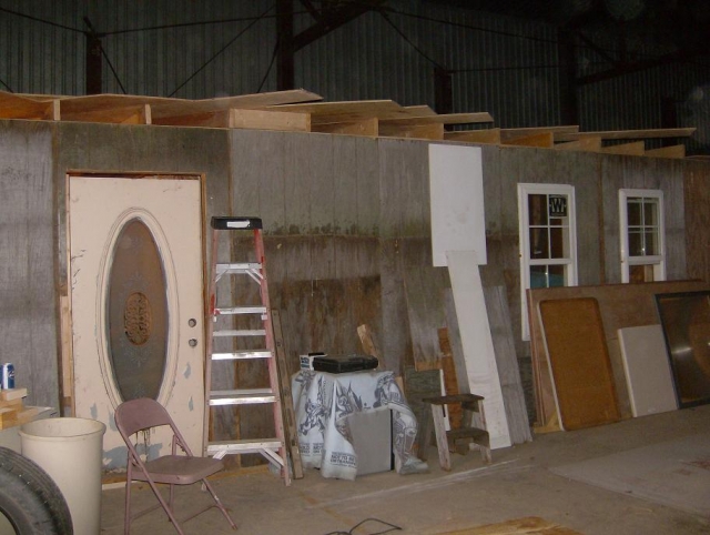

Here is the front. Yep junk is in the way and it needs trim and paint and the door is just temporarly in place but just think of it as the "before" picture. You can tell from this picture the plywood was installed at a 45 degree angle and I have let the ends run wild to be trimmed off later. Bird stops will need to be installed between each joist and a large trim board installed over the joist ends. I am applying a second layer of 1/2 plywood square and true with the joist over top of the first layer for a full inch floor then it can be used as a storage loft as well.
