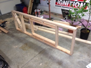

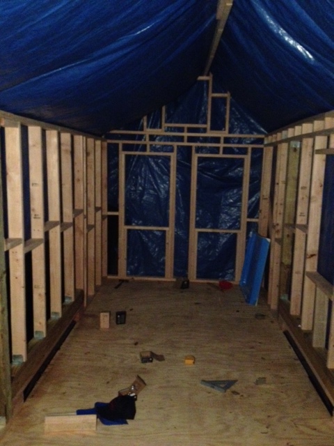

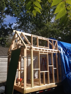

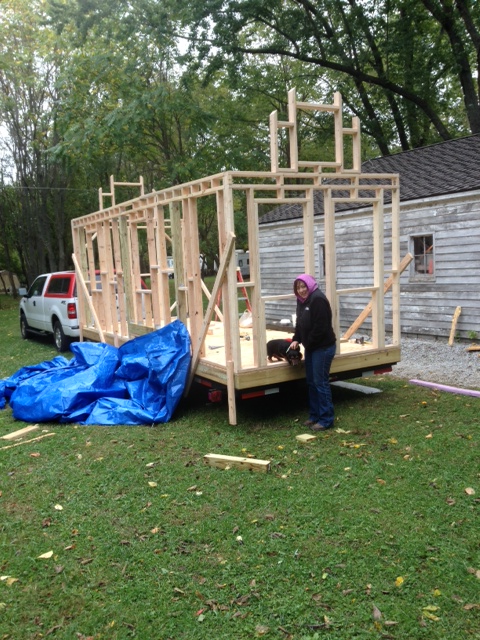

Update from the weekend of 10/4-10/5
Got the long wall, and both end walls stood up. The two end walls we built in our garage over the last few weeks. The sidewall I built over 2 days last week. After all this, yesterday we got all the framing cut for the other side, and got it partially screwed together.

Postby bobhenry » Mon Oct 06, 2014 10:20 am
Hey crew :
Two things have you checked your overall height. Looks like 9' walls to the plate add 2' for the trailer deck height then that 3 1/2 to 4' top knot is gonna put you over the 13'6" max.
2nd thing with all the rain coming at you you might want to get something on that floor the first dry day you get. I used fence post protectant about 6 - 7 bucks at rural king. It will take a day or two to dry but you can throw down some plywood to walk on and still later use it on the sidewall sheathing.
You guys are steaming along!
Re: Adam & Lisas Tiny house build
Postby crpngdth2001 » Mon Oct 06, 2014 11:19 am
bobhenry wrote:Hey crew :
have you checked your overall height. Looks like 9' walls to the plate add 2' for the trailer deck height then that 3 1/2 to 4' top knot is gonna put you over the 13'6" Max.
+1 on this if it is ever leaving the property, or if you might ever want to sell it to build a "new and improved" version.
Postby camaro2813 » Mon Oct 06, 2014 9:29 pm
it will top out at 13 foot 1 inch before putting the steel and ridge cap on.

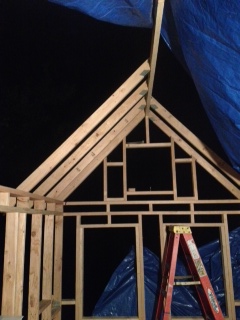

Postby camaro2813 » Sun Oct 12, 2014 10:08 pm
ridge beam all set
ridge beam.JPG (67.86 KiB) Viewed 4632 times
this happened on Wednesday thru part of Thursday oct 8-9th
rafters going up
Postby camaro2813 » Sun Oct 12, 2014 10:15 pm
Dormers prebuilt Thursday night. Saturday installed dormers, finished up steep portion of rafters.
Sunday was materials run, and got the front (kitchen/bath) wall fully sheathed. All dormer rafters are cut and mostly installed, waiting on picking up a few more hangers.
