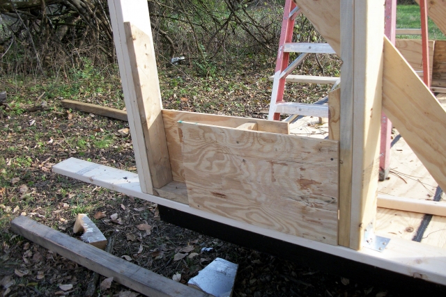

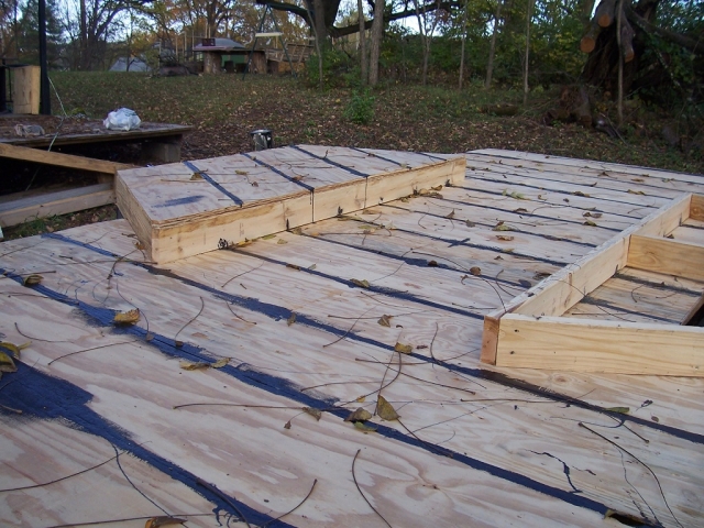

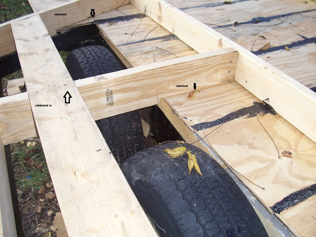

Powertools in the rain ! It sounds like a song title doesn't it ? Well the pooch outs are raised and covered ( I will have pics Tuesday) What a nightmare :frightened:
30 degree corner connections and dados cut in members to allow for the deck height change and ripped lumber to get 4 3/4 thick stock out of 2x6's but one pooch out is complete and the other just needing the plywood deck. I stopped in the misty rain and decided to dribble some fence post coating on the sheet seams to help weatherproof a bit. The asphaultic coating was as thick as molasses on a January morning but I dribbled what I could where I could. I really wanted to coat the entire floor but that just wasn't gonna happen on a 45 degree rainy overcast day. It will rain all day today so no progress Sunday. :x Running out of fall weather :cry:

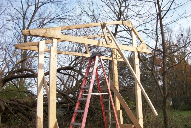

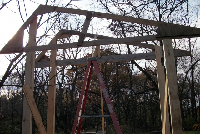

Well with a lot of head scratching and redneck engineering two of the truss /wall stud combo assembles are standing and braced. A hinged push pole was used to catch the assembly as it was lifted to about 60 degrees on one side then a rope to pull it upright was utilized on the other side. They were stood to a temporary stop and tied off until a few adjustments were made and then screwed off to stabilize the assembly. The other wheel well was decked with 2 layers of 1/2 plywood to cap it off so the 3rd truss legs could be designed. As only a portion of one of the two uprights set on the plate and the other leg rests on the wheel well cover there is a bit of fitting to be done. The decision to make bent assemblies has been a good one. The legs actually screw to the top and bottom chord of the truss so hurricane strips pale in comparison to the uplift protection of this design. It also makes setting the trusses a whole lot easier doing it as one piece. I will be cutting some dummy boards to correctly space the legs to obtain the 33" cavity I have designed for. A similar setup will be made to correctly space the trusses to their 34 1/2 inch cavity space. The difference is the studs are doubled up while the trusses are only one member. I had pictures to post last Tuesday and could not fid the camera. Well the good news is it was in the parking spot I use and the miracle was it had not been ran over so I will have a bunch to post soon. P.S. Budget is now at $345.00 with some outside help yesterday.

Well it's picture day ! ( And I still didn't get them all)
The pooch outs
the zebra deck almost done
Made 10 sets of legs ALL WRONG ! :x

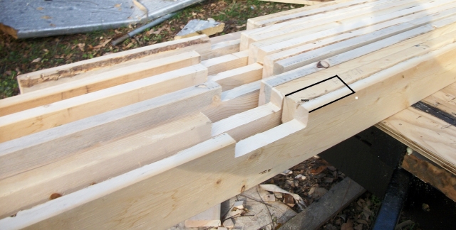

Here are 2 trusses standing you can see where the continuious header will ride in the notch. Yes some dumb ass forgot to notch the gable end truss but a saws all will take care of that. It's just harder in the air.
aligning spacer to stabilize and correctly space the trusses.

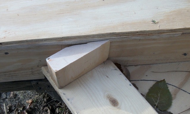

this is a test for the bias cut I had to make on one of the set of trusses the companion leg will be cut short and ride on the raised wheel well cover!
Here is the hinged push stick and if you look hard you can see a white tail this was used for my helper to pull and stabilize until I could get things temporarily braced.

Four of the seven truss bents are now up and squared and braced with temporary supports. After running over my camera with the truck. ( Earlier reports said I missed it but that was in error) So I will have to get caught up on the pictures by borrowing a camera (until Goodwill finds me another :roll: )

As I stood looking at this raised area to accommodate the wheel wells I have all but decided to level out this possible trip hazard. The space underneath would form a shallow storage area with a couple lift up lids and the front facing into the step down living room could have a couple nice storage drawers . As they are only about 4" deep what would they really be good storage for? Linen and clothing maybe but what else.

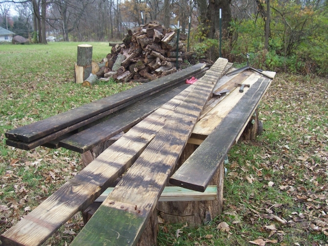

Stayed after work and cut the free steel roofing to length. We are doing a late fall cleanup of the plant grounds and I was donated about 20 16 foot 2x4's and 2x6's . They look kinda like a porcupine with all the nails sticking out. However, in the wall blocking doesn't have to look pretty. All I have to do is get all the nails pulled. It won't be the first time.......
That's plain crazy these boards were found in a side ditch in NOVEMBER of last year!
Re: DEPOT
Postby bobhenry » Sun Nov 19, 2017 3:53 pm

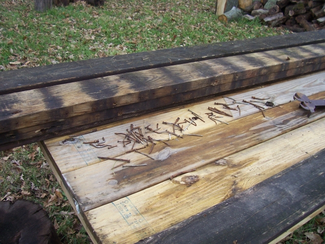

Well Saturday was underwater all day . Almost 5" of rain ! Sunday was a bit better but cold and cloudy. I was determined to get a little something done so I took 3 hours and pulled nails ( and pulled nails and pulled nails) The free lumber is now metal free and ready for recycling. I wound up with a 1 pound coffee can of used nails and it was running over. Tomorrow will be sunny and very nice (For Nov.) and my help will be available so we will have all the trusses set, the purlins in, and hopefully a good portion of the roofing steel installed. Hope to snap a few more pics late Monday night and show off the progress. :D
