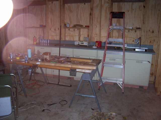

here are the steel cabinets and counter top Image

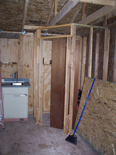

here is the potty area rough framedImage

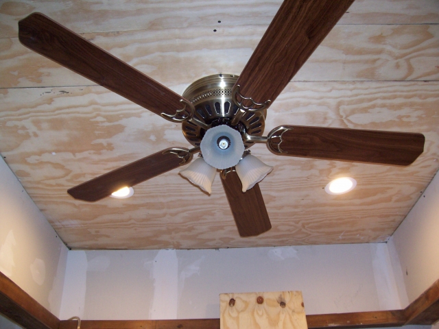

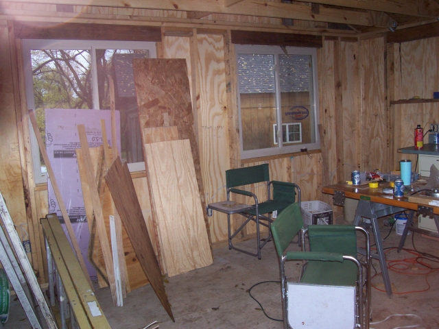

Removed one bottom truss chord and installed the ceiling fan...Image
Starting to look like home ( all cluttered up ).....Image

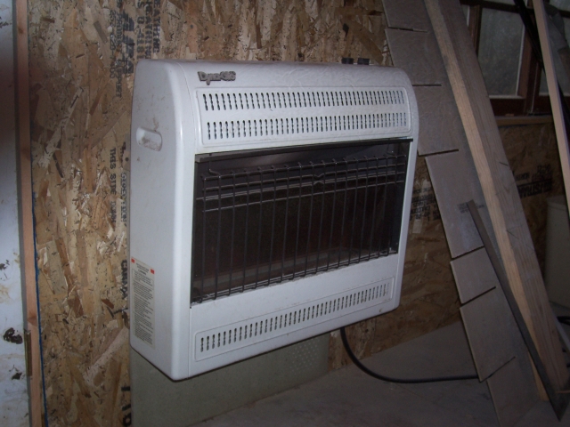

Forgot to mention that Monday I was able to snag a 30k BTU vent free gas wall heater for $55.00 off of a local yard sale listing on the net. Land lady is having doubts about it and the saw dust but I reminded her we will also be having a wood stove installed so what is the difference. I installed a 12k BTU unit in the Depot and it has proven to be a bit undersized for severe cold so I will put the 30 K in the Depot and the 12k in the shop. This weekend I need to work on heat and the insulation so winter work can continue.

It's 18 degrees this morning. I have decided to install the 30k gas heater TODAY ! in the shop as temporary heat. I had 7 of my 20# propane bottles filled and stopped by my old shop and begged for scraps. I loaded my pickup with all she would hold of window and door cut outs of 7/16 OSB. 3x5 4x6 and 2 x 8 pieces mostly but others as well. I will scrap in the walls with the OSB after insulating them. Later drywall can be applied with great ease. ( No worry about hitting a stud and shelving will be easier to install as well.

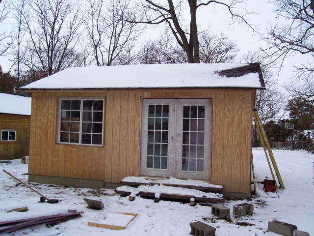

Image We were able to coat a few sheets of the siding before installation with the weatherproofing until we ran out :NC
2 old farts started on this corner and had trouble holding them up while the other nailed so the margin at the bottom is a bit uneven. As we progressed we learned a trick and used a concrete block and a 5 foot 2x4 to lift and hold the siding in place much more solidly . It will look fine when done as a water table board will be added at the bottom and at the gable transition. I wanted all the trim installed after we coat the siding and tape the corners with butyl tape to keep out the weather.
Image My brought back from the dead french doors. A bit muddy but swinging :thumbsup:
OH the steps are very very temporary . I is simply a pile of landscape timbers arranged in a manner so that only 1 or 2 had to be cut so they can be reused elsewhere on the landlady's farm later.

Today was the first real test of the 30 k propane heater. I went up to the shop about 9:30 and all was stone cold but it was about 40 outside. I fired up the heater first thing. I paid little attention to it until just after noon when I realized 5 was too high ( goes to 8 ) . I reset it to "1" ( the lowest setting) . By 2 pm I just turned it off. I was busy making let down self leveling shelving and didn't realize until then I was actually breaking a sweat in my hooded sweat shirt. Yep we are ready for -15 here in Indiana this winter.

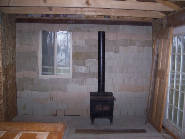

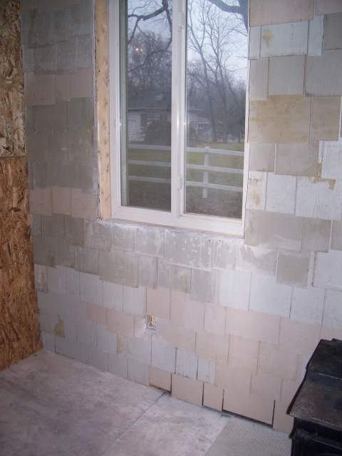

Re: sheryl's she shed
Postby bobhenry » Thu Nov 28, 2019 7:44 am
Set the ceiling joist storage unit in the corner for the moment and just had to get the concrete Hardi board shingles up behind the wood stove. It really looks sweet. It was a long five hours doing just 120 +/- square feet but there were outlets to cut in and windows to skirt around so it did take some exacting measuring and deft use of a small 4 1/2" grinder but boy does it look goods. With the 50+ MPH wind gusts we had yesterday it was nice to work inside and the little propane wall heater made it very comfortable. I will dust off the camera and get some pics today.

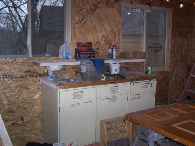

Image The tool storage cabinets
