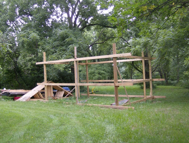

bobhenry wrote:While not related to the house in a house here is how I have been spending some of my weekends just to stay busy. :laughter:
OLD POST UPDATED 8/18/14

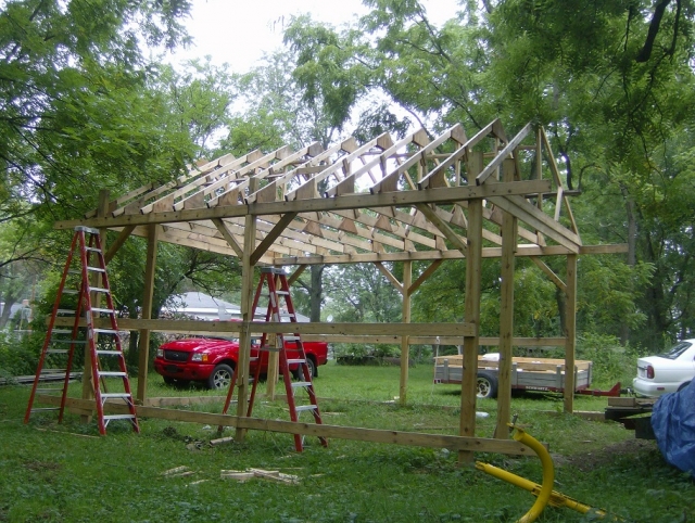

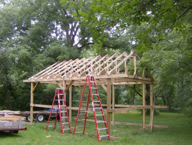

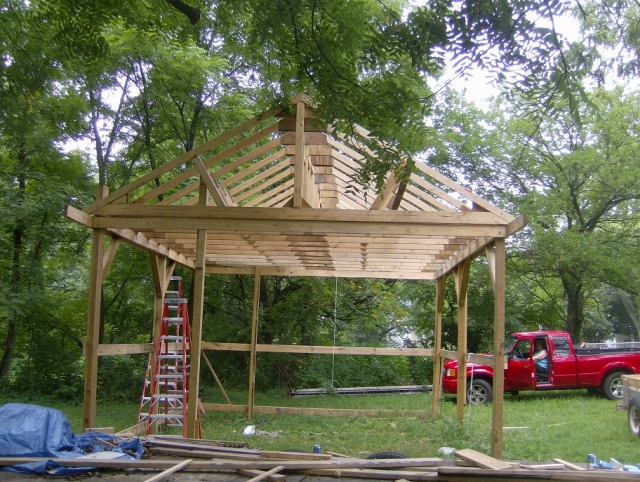

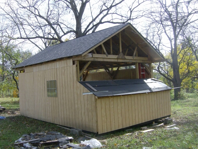

Got some new pics of the pole barn project.

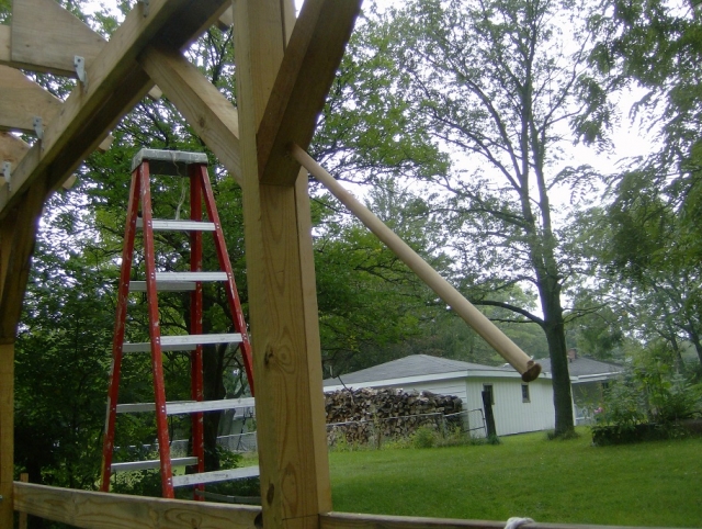

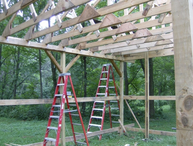

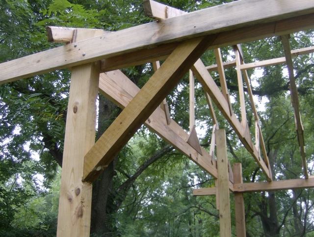

pegged the diagionals with 1" hardwood dowels
The 2 foot cantilever at the ends will support fly rafters so total length will be 24 foot ( no wasted plywood ) :D
here is one peg being driven in. Note the hurricane clips on each truss to plate connection !

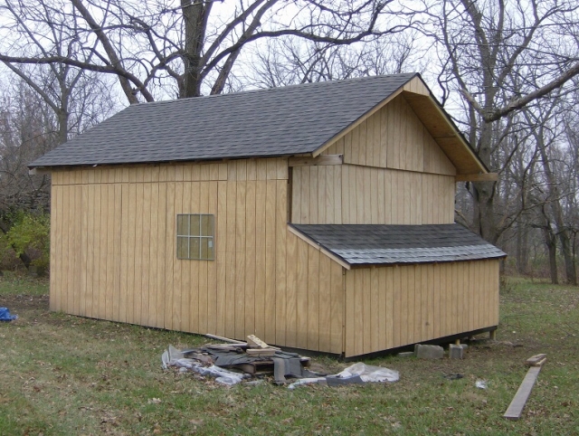

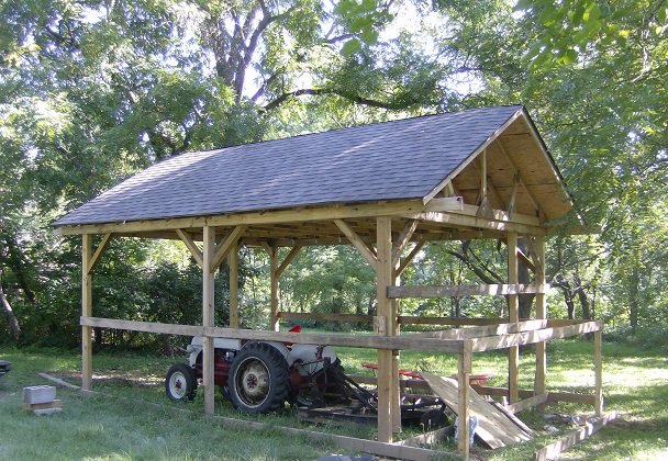

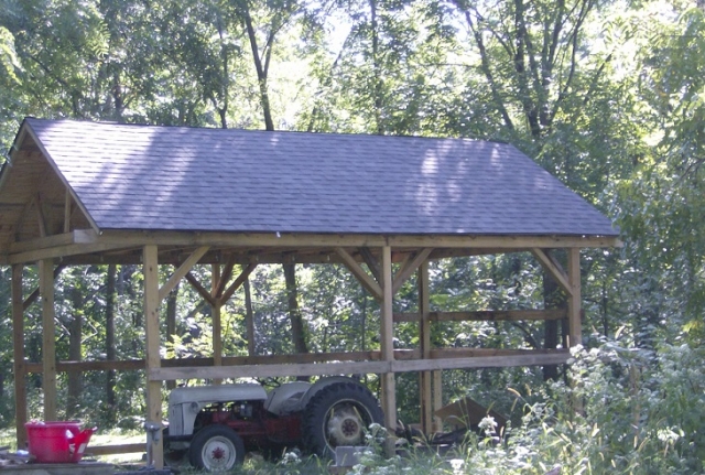

UPDATED AGAIN Here is the latest with the roof shingled
The little growth on the back is a 5 foot tall dog house addition. It will be open behind the tractor just in case the bush hog mower gets backed in a bit too deep.
The bottom girt board in the pic will be removed for the 12 foot width. The little 3 x 4 area remaining on the far end is reported to be a future nesting box for a few chickens. :?

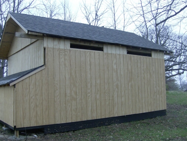

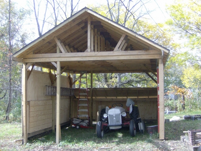

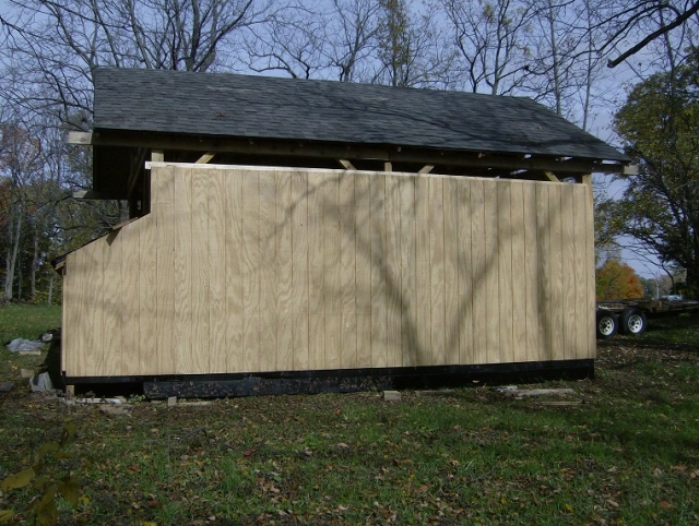

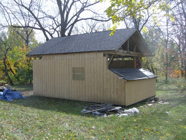

As I think I mentioned I called in the troops as I only had one good hand and Sammy and Allen jumped up and finished weathering in the barn. All that is left is a garage door and service door installation and about 200 feet of corner and joint trim and it's done done done !
Yep we mixed in a few shingles as we were running short!

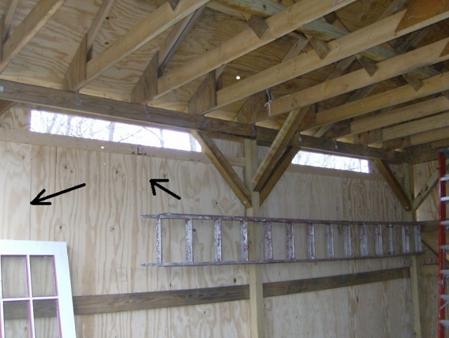

These two south facing openings will be glazed with the last of Chubby's bronze lexan as celectrial windows.

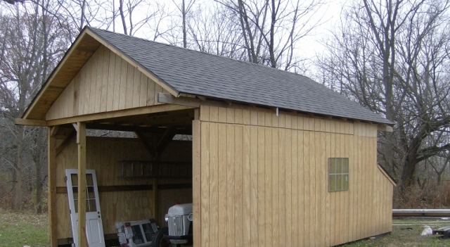

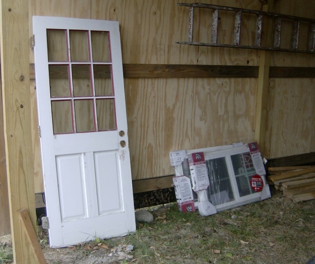

Found an absolutely free 9 light wood door and it more or less matches the 4 light horizontal slider windows beside it.
Need to get the test window down and install the sliders and install about 200 feet of corner and joint trim and it will be beautiful even if I say so myself :roll:

Since it is so far between girts a 2x4 will need to be installed vertically at the panel joints to keep them aligned not a big thing just one more little task. :roll:

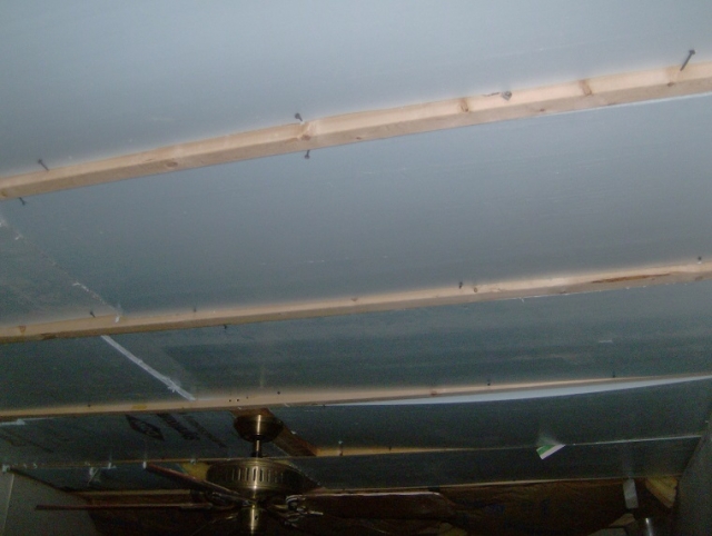

Trying to stay warm has been a bit of a challenge since winter arrived early ( single digit wind chills) I decided to get busy with the ceiling insulation.
2 layers of r 11 fiberglass blankets didn't want to stay in place without drooping so I solved the problem with some 1" blue residential Styrofoam.
Now R 22 plus R 5 for the foam total R 27. Makes a big difference in the comfort level. The drywall is next just need a good helper for the day and about another week for my two amputated fingers to further heal.
