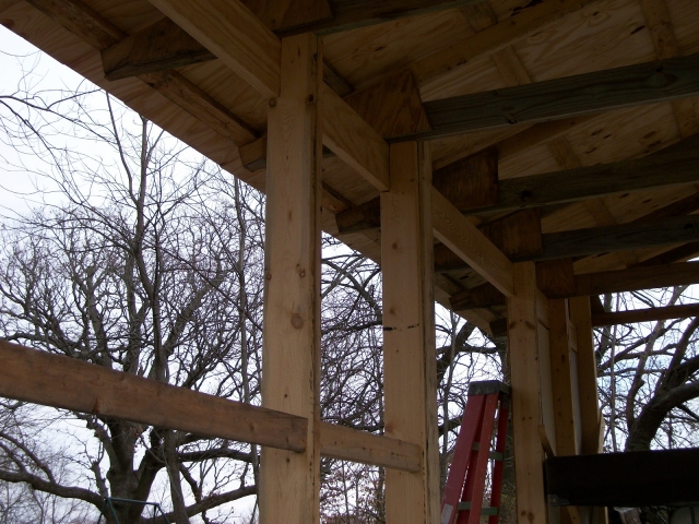

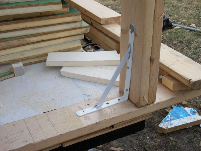

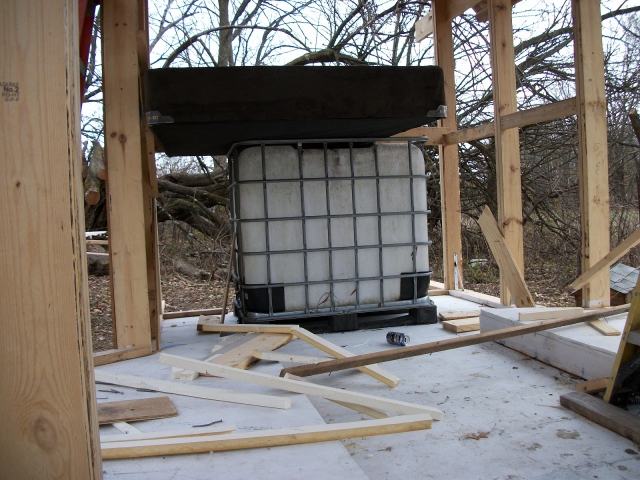

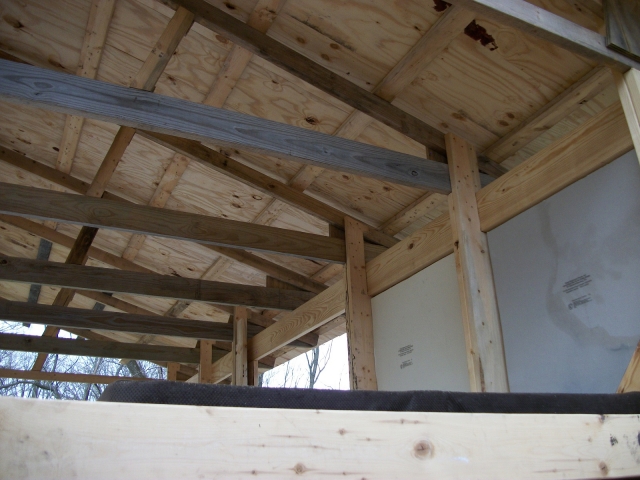

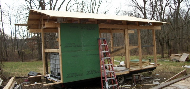

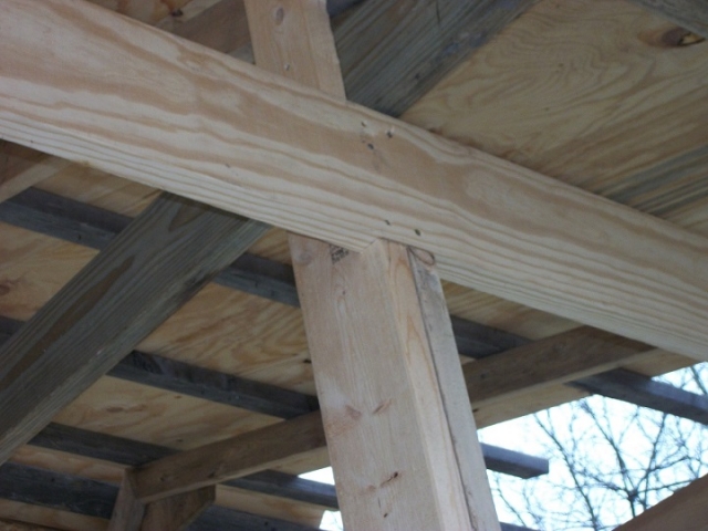

If anyone is out there here are some more pics.............
found a heavy duty shelf bracket for a super hold down.
here is a good shot of the unorthodox framing connection ( look ma no top plate )
The scrap in patch on the south facing steep roof
In the middle is the flying truss over the pooch outs it simply sets on the continuious header.
You can see the back side of the zip wall's 1 1/2 insulation in this picture also
the header resting in the notch with four 3inch construction screws as fastners.
My water tank under an old box spring as a design experiment.
Here is the scrap zip wall being installed
