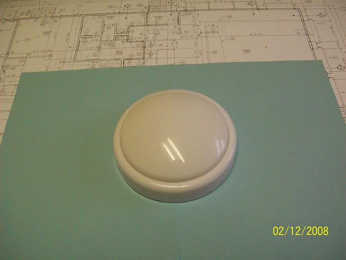

The 5 ceiling registers on each side of the tiny house will be mounted in this flat area I wanted the ventalation and at the same time felt it would be a great opportunity for some type of lighting. I have decided to use these simple tap-a-lites as the difuser plate for the HVAC drops. They will be gutted and low voltage LED bulbs will be installed as well as a very low wattage 120 volt 4 to 7 watt christmas tree type bulb. I see no reason why the pvc air duct can not also serve as the electrical conduit to these light. By adding a stand off bracket to the back of the tap a lite and making a quick attachment to the pvc drop. The tap a light will now redirect the stream of air in a more horizontal path.

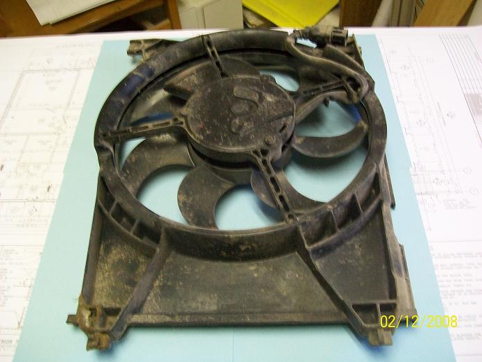

I mentioned only yesterday needing two 12 volt radiator fans to our delivery driver. I knew he dabbles in scrapping and often is hauling in junk cars to the scrap steel guys. Look what he handed me this morning.....

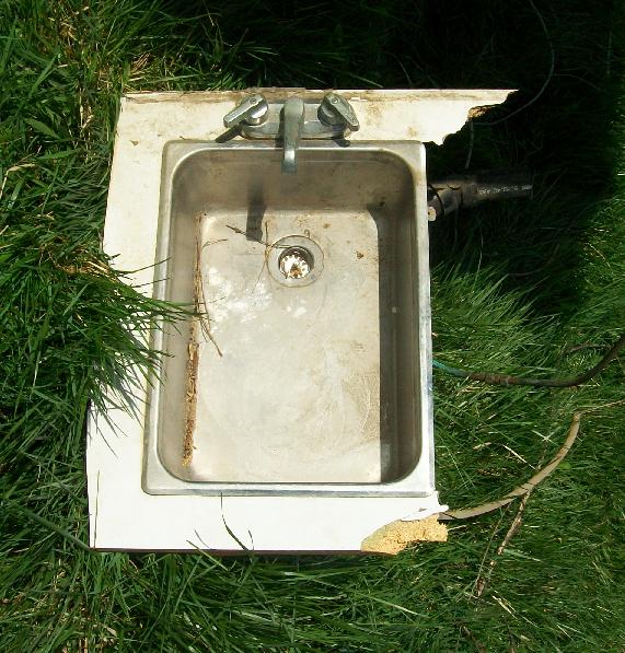

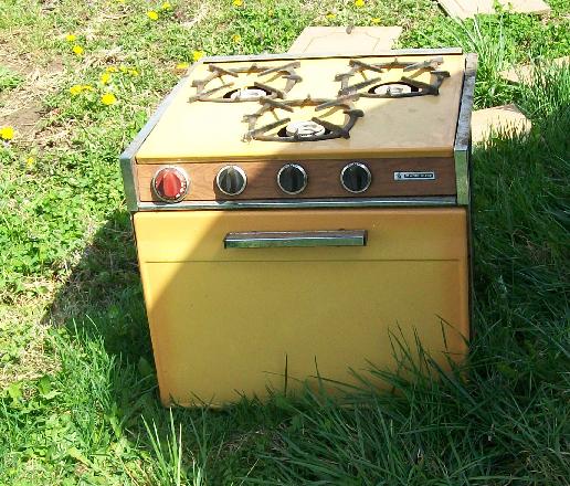

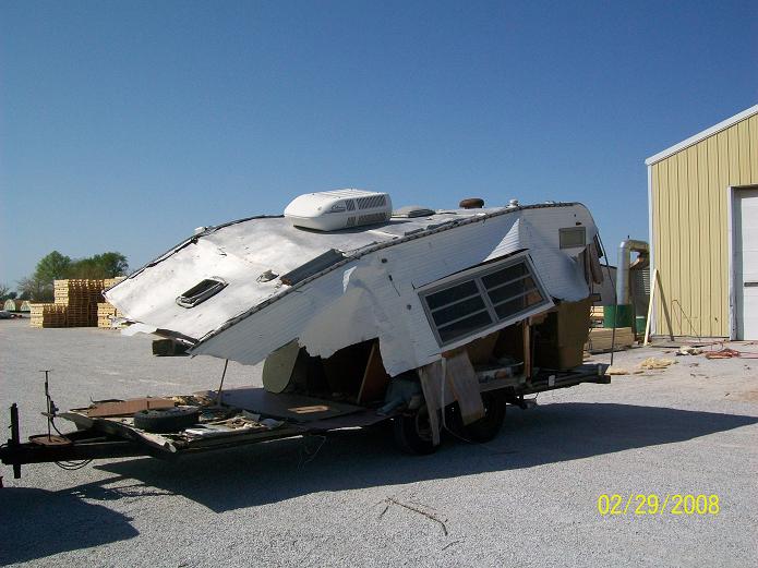

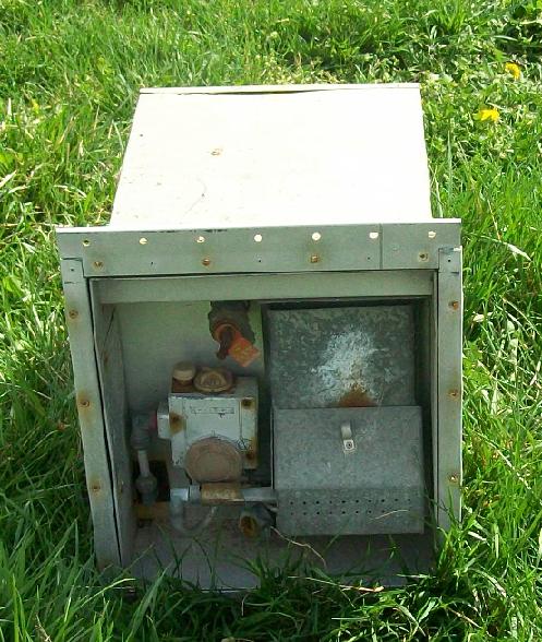

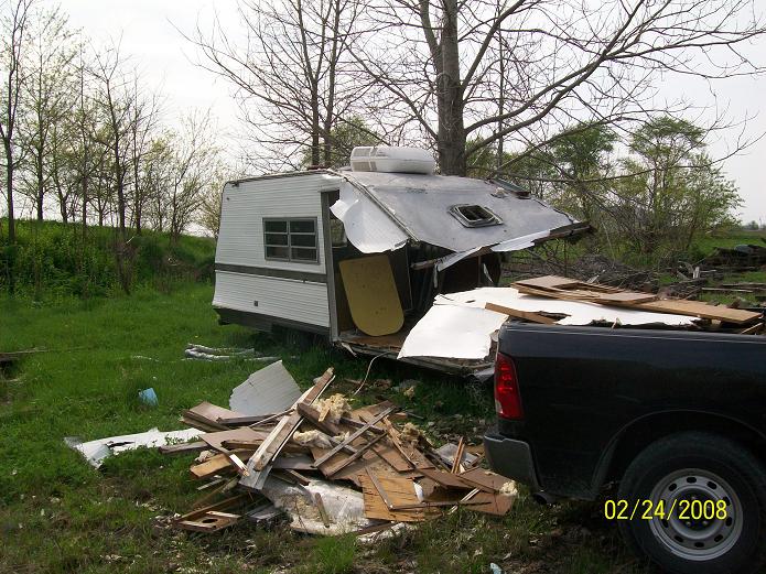

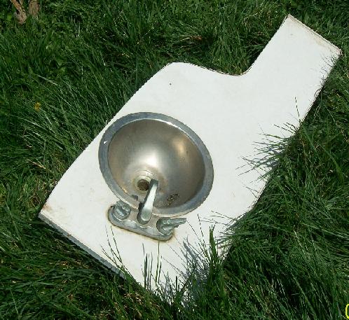

I got lots of toys this week for the demolition of a 16 foot camper......
the donor
bathroom lavatory
cabinet doors
sink
stove / oven
wter heater
And a gas furnace with thermostat and a 15 -20 gallon water tank that I aparently forgot to take pictures of :roll:

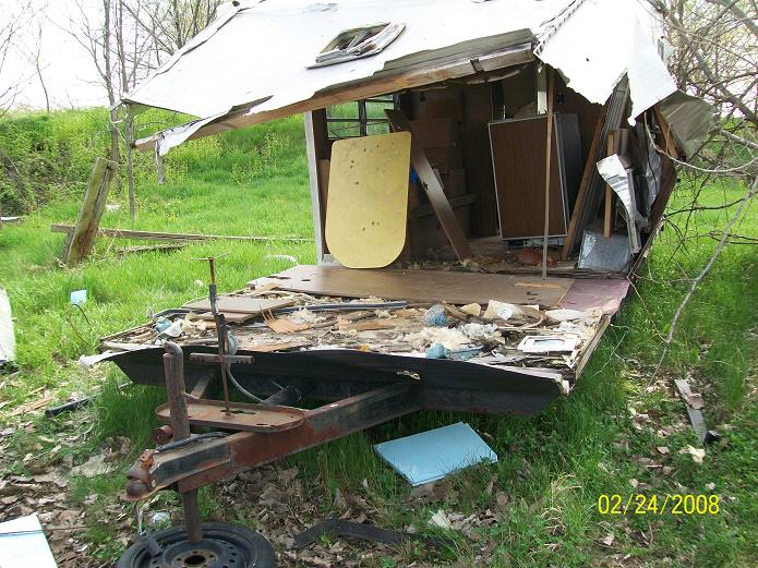

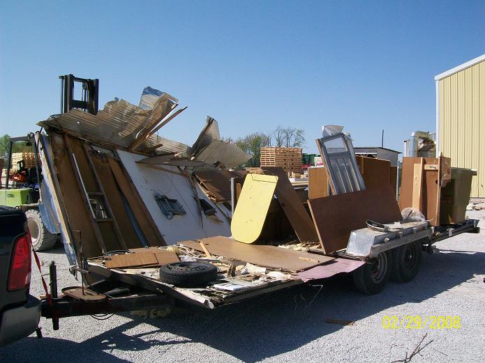

The demolition began yesterday. Took a few hours after work and took a full truck load of trash out of the caboose's donor frame. Managed to salvage a bunch of neat little items.
It's sawsall time Sunday :twisted:

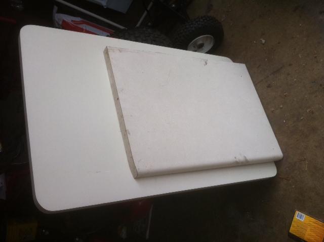

I have a couple countertop pieces and wondered if you wanted them for your newest project. If not I am going to dispose of.
(28X45" island top)
(22X32.5")
(22X45.5")
Have I ever mentioned I love "FREE" :lol:

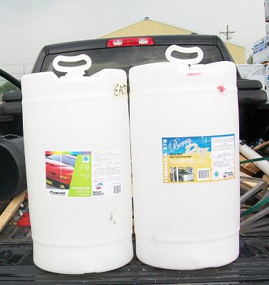

Well Sunday I got my onboard tanks for the Caboose. Actuall I bought six of these.....
I had been looking on Craigs list all over the state and no luck :cry:
Friday on my way home I saw a trailer FULL of them in an open garage so I stopped and asked if any were for sale. I was told $5.00 each and he had 40 of them :D
So I got his number and told him I would have the cash for him Sunday AM and they are now home :thumbsup:
They had had car wash soap in them so there should be no problem rinsing them and being able to use them even for pottable water .

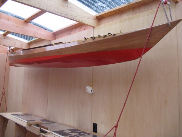

POLYCARBONATE ROOF
Tripped over this pic in my internet wanderings........
This set me to thinking :thinking: (A very dangerous thing)
The caboose cupalo will be approx 6'x8' and it might work nicely as a source for natural light and solar gain for heating. As a queen bed is planned to be able to be raised and lowered from the cupalo it could be utilized as a baffle of sorts. It would stop unwanted solar gain in the warm months. A 12 volt powered vent fan could collect the heat and either exhaust it outside or gather it if needed to direct it to floor registers for free heat.

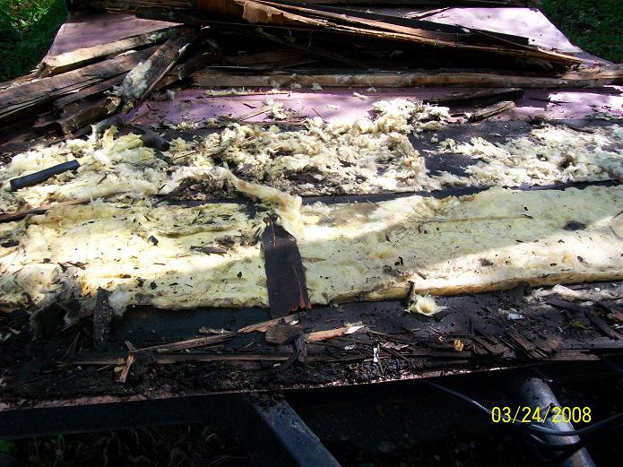

A demo pic showing the scant insullation in the donar carcus...............
