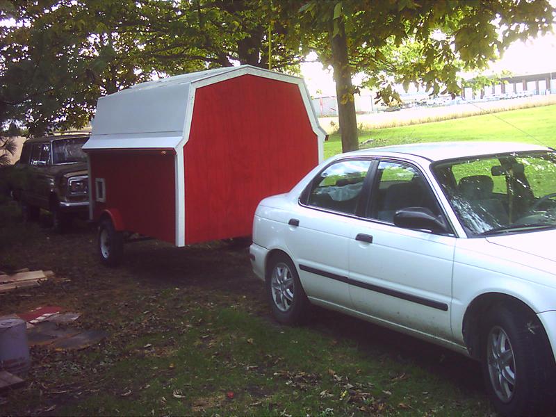

Here was our set up when we went to Morris Il. 3 weeks ago.

Postby bobhenry » Sun Nov 08, 2009 9:41 pm
Sorry out of state all weekend and out of touch. Best guess trailer is 1200 lbs. It pulls easily with my 4 cylinder Suzuki Esteem. Inside height is 5'4" Barn is exactly 5 wide by 10 long. If you follow the thread all the way back you can see that every effort was made to cut the wood members to what I felt was minimal size without giving away the necessary strength. The let in bracing is a wood member glued and screwed in a grove plowed in the vertical members to tringulate for extra strength.
As to scaling down weight wise I don't think it would be possible to build much lighter without losing a great deal of strength. The roof is aluminum coil stock over 3/8 plywood then 2 layers of 3/4 foam in the cavaties and 1/4 luan interior liner over the bones. I lifted the entire roof framing onto the barn side walls by myself before adding the aluminum. It is designed as light as I dared. The framing 2x4 were cut down to 1 1/8" by 2 1/2 " actual size. If you are talking about scaling down size yes 4x8x4 tall would still give you the exact same barn look. Perhaps a mock equipment sidewall door for entry instead of the rear entry as I have.
If you are serious I will be happy to help anyway I can.

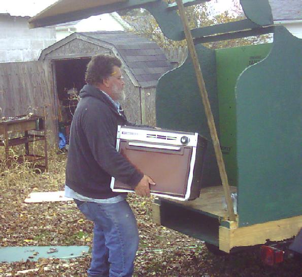

Since my "KITCHEN" is to become part of the barn I will continue the Wishbone wagon build as a portion of my barn thread.

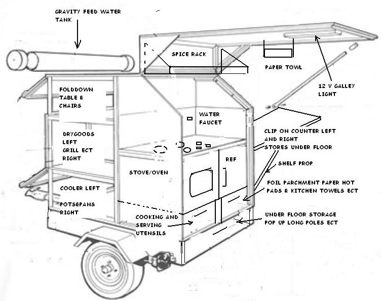

Here was the concept drawing ..............[Image

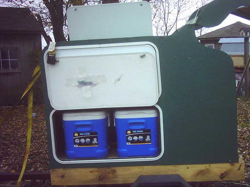

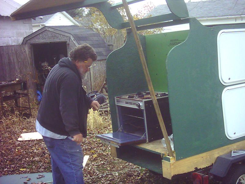

And here we go Image

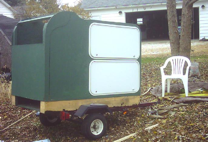

Postby bobhenry » Mon Nov 16, 2009 3:34 am
Postby bobhenry » Mon Nov 16, 2009 3:36 am
Postby bobhenry » Mon Nov 16, 2009 3:37 am
AND THE COOLERS ACTUALLY FIT :D

Looks like a fun and less-conventional build, thoroughly thought out, a huge kitchen for serious cooking on a truly tiny trailer. One thought from me? The light on the galley might be better closer to the hinge, or better yet, under that clever spice rack, so the cook won't always be blocking his/her own light and casting a shadow on the counter top, come dark.
